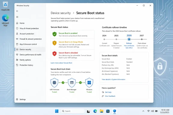

The Green Checkmark Is Useful, but the Text Matters More​
The quickest route is straightforward. Open the Start menu, type Windows Security, launch the app, select Device security, and look for the Secure Boot section. On updated systems, Microsoft’s newer status text should tell you whether the required certificate updates have been applied.
The badge color gives the first clue. Green generally means the system is sufficiently protected and no action is recommended. Yellow means Windows has a safety recommendation, often because the PC is still on an older boot trust configuration or because more information is needed before the automated update can complete. Red is the serious state, indicating that the device needs immediate attention because it can no longer receive a required update for the Windows boot experience.
But Microsoft has been careful to warn that a green icon alone is not the whole answer. A PC can show Secure Boot as enabled without necessarily proving that the certificate migration is complete. The more decisive message is the one that says Secure Boot is on and all required certificate updates have been applied.
That distinction matters because “Secure Boot is on” and “Secure Boot is ready for the 2023 certificate era” are adjacent but not identical claims. The first is a feature state. The second is a trust-chain migration state. Microsoft has now put both concepts in the same neighborhood of the Windows Security app, which is good for users but also easy to misread.

The Practical Read on Each Badge​
The new Secure Boot status system is useful because it gives users a sane first step. It does not require a Microsoft account, a third-party scanner, a BIOS menu, or a command prompt. It also does not require trusting random utilities that promise to audit Secure Boot readiness.
Green is the desired destination, provided the accompanying text says the certificate updates are complete. Yellow is a prompt to make sure Windows Update and firmware are current, then give the device time and restarts. Red is the state where ignoring the warning may leave the system unable to receive required boot-security updates.
The most important thing to avoid is overreacting. Do not disable Secure Boot just because you saw an article about certificate expiration. Do not reset firmware keys unless you know exactly why you are doing it. Do not install BIOS updates from anywhere except the PC or motherboard maker.
If the Windows Security app says Secure Boot is off, that is a separate issue from the certificate migration. Some users disable Secure Boot for Linux installations, legacy hardware, or troubleshooting. But a disabled Secure Boot state means the certificate update path is not protecting the boot chain in the way Microsoft’s guidance assumes.

Microsoft says Windows 11 and supported Windows 10 PCs can verify the Secure Boot 2023 certificate transition through Windows Security, System Information, and administrator diagnostics, while older or unsupported machines that miss the update will keep booting after June 24, 2026, but lose future boot-level protections. That is the quiet but important distinction behind the latest round of Secure Boot anxiety: this is not a doomsday switch, but it is a line in the sand. The PC will not brick itself when the old certificates expire, yet its ability to learn about newly distrusted boot components will gradually fossilize. For Windows users, the story is less “will my machine start?” than “will my machine remain part of the modern trust chain?”
UEFI Secure Boot status screen shows trust chain and “Secure Boot is ON,” with upcoming 2026 certificate timeline.Microsoft’s Secure Boot Deadline Is a Security Cliff, Not a Power Switch​
The panic around Secure Boot’s 2011 certificates has always been easy to understand. Certificates expire, firmware is opaque, and the phrase “boot security” sounds uncomfortably close to “your PC may not boot.” Microsoft’s latest guidance is meant to calm the first fear without minimizing the second-order consequences.
The company’s position is straightforward: a Windows PC that reaches the expiration date without the new Secure Boot certificates should still start and operate normally. Standard Windows updates continue to install. Users should not expect a forced reboot loop, a dramatic firmware error, or a midnight transformation of a working desktop into a paperweight.
But the absence of catastrophe is not the same as the absence of risk. Secure Boot is part of the chain of trust that starts before Windows loads, and that chain depends on firmware knowing which boot managers, bootloaders, and signatures are still acceptable. Once a device is stranded on the 2011-era trust material, it becomes progressively less able to absorb future revocations and boot-layer mitigations.
That distinction matters because Microsoft is trying to move a sprawling Windows ecosystem across a generational certificate boundary. It can update Windows. It can ship diagnostics. It can stage the rollout through cumulative updates and confidence checks. What it cannot do, at least not universally, is make every firmware implementation from the last 15 years behave like a well-maintained 2025 business laptop.
The Green Checkmark Is Doing More Work Than It Looks​
For most users, the only visible sign of this transition is now supposed to be a status indicator in Windows Security. On updated Windows 11 systems, Device Security can show whether the machine has received the Secure Boot 2023 certificates, whether the update is pending, or whether something in the platform is blocking the process. That is the consumer-friendly version of a much more complicated firmware migration.
A green result effectively means the device has crossed the bridge. The relevant Secure Boot 2023 material has been applied, and the PC should be able to keep receiving future boot-level updates. A yellow result is more ambiguous; it may mean the device is waiting on Microsoft’s rollout logic, telemetry confidence, or another step before the update is applied.
Red is the warning that deserves attention. It usually means Windows has detected a condition that prevents the update from being safely applied, often involving firmware compatibility or platform readiness. In other words, the failure is not necessarily in Windows itself; it may be in the BIOS or UEFI layer that Windows has to ask for permission.
The missing-status case is just as important. If Secure Boot does not appear in Windows Security at all, the machine may be running in Legacy BIOS mode, using Compatibility Support Module behavior, or sitting in a state where Secure Boot is disabled or not properly configured. For those systems, the certificate transition may be irrelevant because Secure Boot is not active in the first place.
System Information remains the blunt but useful fallback. Running msinfo32 and checking “Secure Boot State” can tell users whether the feature is On, Off, or Unsupported. That will not explain every certificate nuance, but it quickly separates “my Secure Boot update failed” from “this PC was never participating in Secure Boot as Windows expects it.”

For a typical user, the practical workflow is mercifully short. Open Windows Security, go to Device Security, and inspect the Secure Boot section. If it is green, stop worrying. If it is yellow, make sure Windows Update and firmware updates are current, then give the staged rollout time to do its job.
If it is red, the next stop is the OEM support page for the exact model. Not the product family, not a similar-looking laptop, but the precise service tag, serial-number match, or motherboard revision. BIOS updates are specific for a reason, and Secure Boot key handling is not the place to improvise.
If Secure Boot is missing entirely, the user has to determine whether the machine is in UEFI mode with Secure Boot disabled, in Legacy BIOS or CSM mode, or installed in a configuration that cannot be cleanly converted. On some systems, enabling Secure Boot is straightforward. On others, it can expose partitioning assumptions, bootloader changes, or BitLocker recovery requirements.
That is why casual advice to “just turn on Secure Boot” can be dangerous. A technically confident user can prepare recovery keys, back up data, verify disk partition style, and check firmware settings before making changes. A less technical user may be better served leaving a stable old PC alone than entering firmware menus based on a vague internet checklist.

  • A PC with a green Secure Boot status in Windows Security has most likely completed the important part of the 2023 certificate transition.
  • A yellow Secure Boot status usually means the device is still waiting on rollout confidence, update sequencing, or additional platform data rather than being permanently broken.
  • A red Secure Boot status should send users to Windows Update, the OEM firmware page, and model-specific support information before they assume Windows itself is at fault.
  • A missing Secure Boot section usually points to disabled Secure Boot, Legacy BIOS or CSM booting, or unsupported hardware configurations where the certificate update may not apply.
  • A device that never receives the 2023 certificates should continue to boot, but it should be treated as unable to receive future boot-level revocations and mitigations.
