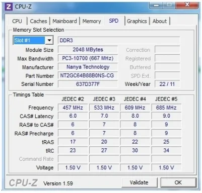

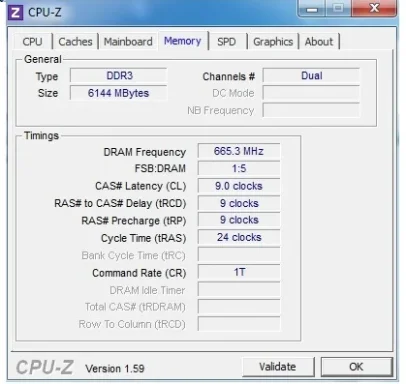

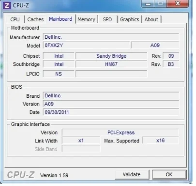

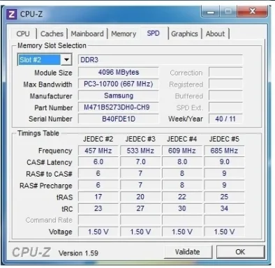

I have do all you want, if anything missed, I will do this step again. Minidump cannot find.

The dtsoftbus01.sys driver has been known to cause problems on some Windows 7 systems. This belongs to Daemon Tools Light. I suggest uninstalling Daemon Tools.
Also go into your bios and change the rams Command Rate from 1T to 2T

But I don't have that option to change RAM parameter in bios. I will try to uninstall AVG. What program like Daemon you will recommend to me? Thank you for advice, I think that this will solve my problem. It is embarrassed problem.

Thanks for your advice. Just one more thing about Command Rate, can I change it with any software, because I can't change timing and other things in bios on my Dell.
Best regards
Elmer
Extraordinary Member
Mar 5, 2010
3,864
Best regards
Sadly no. Its a bios thing. Dell, along with others, lock you out of certain areas of bios to protect you from yourself / they no best.
So if your Command Rate is 1T, then 1T it is.
