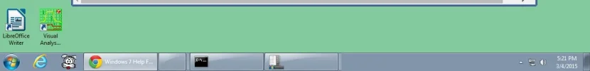

    A Win 7 install on an old server has got me flummoxed. I cannot get the taskbar to function properly. I have tried every trick I have found Googling and none have fixed the problem. I have reloaded the OS twice since the original install and same problems reappear. Once as a Win 7 "upgrade" keeping all my files and lastly as a full HD wipe and a fresh install. The original install used the on-board 8 MB video and same problems occurred. I hoped a new video card would fix the problem. I have loaded all the various versions of windows on different machines and have never seen this issue. I have run every software and hardware system integrity check I know and nothing is found. All my programs seems to function fine.
    Problem:
    If you open and close a program, the icon in the taskbar gets "stuck" and will not go away. If you put a shortcut on the taskbar, it functions on the first mouse click to open. After closing, the icon in the taskbar again gets "stuck" and will not go away. It does not open again unless you to press Shift on the keyboard and then mouse click on the icon. If you open a large number of programs or any task that puts and icons on the taskbar will quickly clutter the taskbar with icons both with and without graphics. There can be no active program, process or task and the taskbar be full of "ghost" icons. Only a reboot or killing and reloading explorer.exe will make the taskbar look normal until you open a program and the whole process continues. I use a bat file to automate the process. I tried deleting the IconCache.db file multiple times but no luck. I would like to know what process controls the taskbar and where the present state is stored.

    Yes I know MS killed Gadgets but I've been using the same Gadgets for years. They are running on a dozen different PCs around my house with no issues, Vista, Win 7 etc. I've done a complete fresh install of 7 including a disk wipe and the problem occurs before the Gadgets are even loaded on the HD. It's some strange hardware/driver issue I cannot identify. I have another similar ancient Tyan dual Xeon MB with Win 7 running with zero issues. I wish I knew more how the taskbar is controlled.
    I've wasted too much time on a basically worthless MB to build yet again another PC I don't need. It's just got me stumped and I don't like it. ;-)

    Ran SCF and chkdsk. No errors found. Event viewer shows a number of errors but not a lot of info on what caused them. Some apps like Wmplayer freeze after a few seconds but most seem to work OK.

    So it could possibly be something else your running? If you do pop Windows 7 on again ( could it be the install disk?) and the same occurrs see if you can remove the icon by deleting it from here:
    C:\Users\user_name\AppData\Roaming\Microsoft\Internet Explorer\Quick Launch\User Pinned\TaskBar

    I've loaded Win 7 three times with two different disks I burned. I confirmed the SHA1 of the original ISO and the resultant DVD. I have used the same ISO before on another dual Xeon PC without issue. I've put tried two different PCI video cards, ATI and Nvidia, first in a PCI-X slot and then in a PCI slot. The taskbar problem never goes away. It does not occur using mini-XP on Hiren's boot CD. Wmplayer freezes after a few seconds. Youtube has issues running full screen mode for videos. It seems to be some strange hardware issue.
