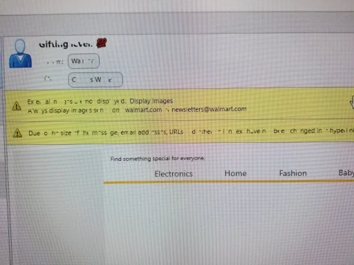

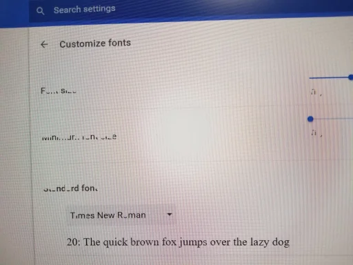

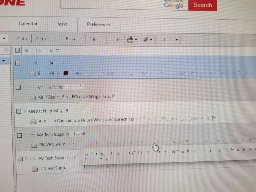

Attached are three screenshots:
32 is from the font section under Chrome
24 is a email from Walmart for todays coupons.
08 is the list of emails in inbox. See how the cursor is over the subject display and still its messed up.

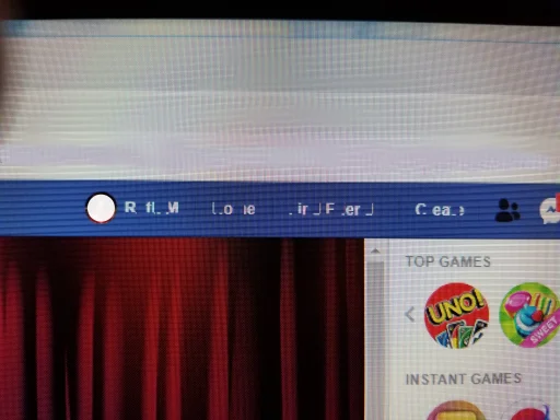

On both computers after running the FontCache instructions I restarted and opened the browser. Email was fine as was fb. On one computer the fonts messed up again after about 10 min of use. I was sitting there the whole time and the user only scrolled through their feed. They did not start any games, click on any other pages, start any programs on the pc.
The first image you can see the settings screen on Chrome where it was starting to show issues.
The second image you can see the text on the fb menu bar go crazy.
After this happened I ran the FontCache instructions again, rebooted, opened Firefox and had no issues. Was there an hour and not a single problem. Opened Chrome (because they like Chrome) and seemed to have no further problems. We'll see if that holds.
