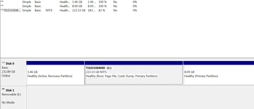

Well surprisingly enough while trying to clean up windows security issues I found there was a service pk to download. I downloaded an well all is really good again.... Or is it? I just got a pop-up window telling me to register my product key. Huh??? I tryed entering my key on the back of the laptop. It told me it was incorrect. I then tryed entering the key showing up in the control panel>system, this one is a OEM, again it wouldn't except it. After scratching my head I decided to look at my partitioning! This is what I found!!!????!!!!:headache:

On the hard drive issues - two observations - the first may have some bearing on what you have been experiencing, the second is just "interesting".
I see you have a recovery partition there which is marked as the active partition - I would have expected the system drive to be marked as active - dont know if that may be causing some delay at boot time.
It's not clear what the 8GB partition is - not doing any harm but might be worth investigating sometime what it's doing there.

Does produkey tell you anything new? If not and your online registration keeps failing then you'll have to phone MS to register.
For the hard drive it's worth tryimg marking drive C as the active drive and see if that speeds up the boot process.
So how do I try this?
