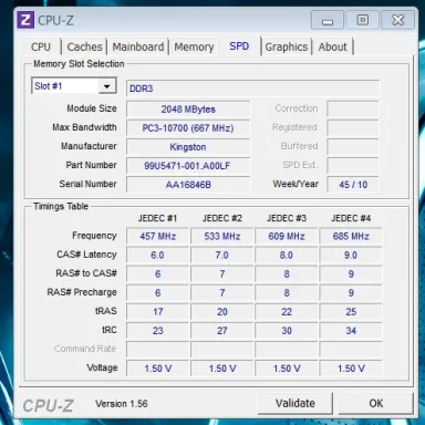

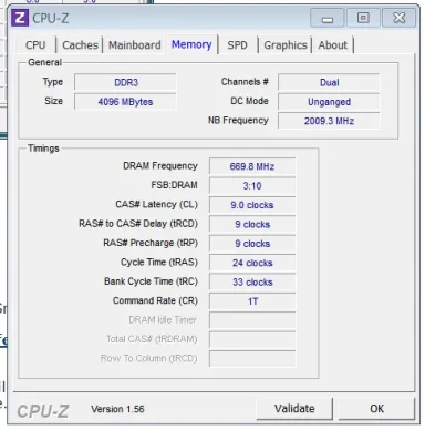

Capture1.webpCapture2.webpI've been getting this very annoying bsod recently, it mostly occurs once, the first time I use the computer after plugging it into the wall. I have windows 7 x64 and have eset nod32 av(64bit). I have already uninstalled my gpu drivers and driver cleaned them, and have also memtested with no problems. I installed fl studio recently and sometimes bsod in that, if this is the cause. I have disabled most unneccesary processes and have flashed bios and updated mobo drivers. I can't seem to find a solution. Thanks in advance.
Memdump is attached.
All the bsods seem to point to ntoskrnl.exe, which is the cause
