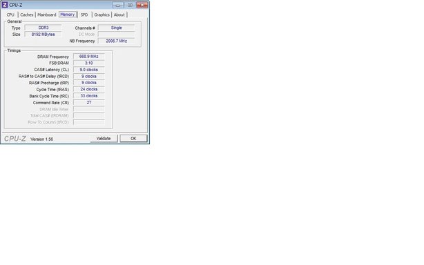

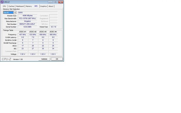

Welcome. You can start by posting the 2 screen shots that my signature below asks for.
Alright, good. Your memory is set well in the bios, for your system.

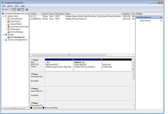

From your good install, it would probably be a good idea to make sure that the other partition you are trying to install to is a primary partition.
Use disk management to look.
Thanks a LOT!!!
Yes it is primary.
The XP ends with blue screen and some srazy numerical message (in either case - 1st or 2nd OS)
Win7 ULT (32 and 64) gives user friendly message that something can not be unpacked or so. If needed I can have exact in 30 min or so . I can try doing it again.
However it installs fine from the same disks when Win7 (32 or 64) ULT is the first OS.
Here is disk manager screen capture
