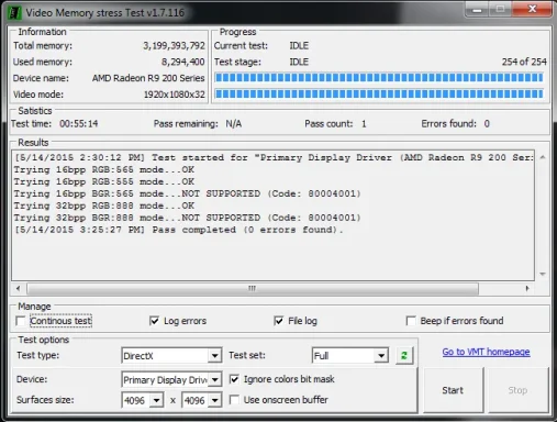

the above dump file has a Bugcheck 116 which basically means the graphics driver didn't respond within a given time and so blue screened. Many things can cause a Bugcheck 116 or TDR and usually it's driver related although I can see in the Stack Text (a blow by blow account of the last sub routines) that your Vram may have been involved. Please check your cards memory by running this test:
Link Removed
I've run the test already, it stated no errors found though.
