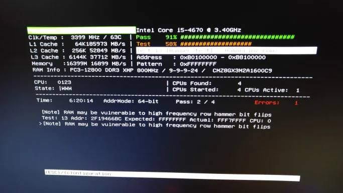

Hi, i recently add on new rams to my computer.. Corsair vengeance 2x4gb, same as my current one with just different version. and i'm getting blue screen and hang on my comp ever since, the error is atikmpag.sys, i have done a memtest on my ram.. need help please !

Hi,
well looking at that memtest86 result you may have some faulty RAM. Try removing the original pair of sticks and testing again.

When i remove the new rams(bought 2nd hand) and start, my monitor cant display..

If im not wrong the original sets are working well.. Do you know whats the approximate duration for a memtest check?
Which RAM did you use when memtest86 failed? If you had both sets of sticks installed then I asked you to remove the new set.
You then said the pc monitor won't work with the old set?
This is all getting very confusing.
Can you simply test the original set of RAM with Memtest86 please. If you look back at my earlier posts you'll see how long to run Memtest86. If the original RAM passes take it out and then test the new sticks.
Firstly i memtest with all the rams inside theres error.. Then i use memtest on the original rams there seems to be no problem.. I havent tried on the new rams yet because i have no time.. The monitor problem occurs on both original rams and new rams separately. Working fine when i used vga cable with a dvi adaptor.. So sorry for my bad english..
