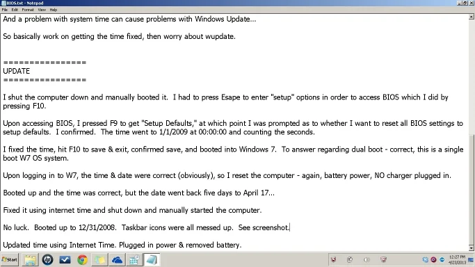

I shut the computer down and manually booted it. I had to press Esape to enter "setup" options in order to access BIOS which I did by pressing F10.
Upon accessing BIOS, I pressed F9 to get "Setup Defaults," at which point I was prompted as to whether I want to reset all BIOS settings to setup defaults. I confirmed. The time went to 1/1/2009 at 00:00:00 and counting the seconds.
I fixed the time, hit F10 to save & exit, confirmed save, and booted into Windows 7. To answer regarding dual boot - correct, this is a single boot W7 OS system.
Upon logging in to W7, the time & date were correct (obviously), so I reset the computer - again, battery power, NO charger plugged in.
Booted up and the time was correct, but the date went back six days to April 17...
So that did not help.

Continuing from where I left off above explaining my attempt at resetting BIOS settings to default:
Fixed it using internet time and shut down and manually started the computer.
No luck. Booted up to 12/31/2008. Taskbar icons were all messed up. See screenshot.
Updated time using Internet Time. Plugged in power & removed battery.
Shut down and manually started it, got some error that windows 7 was not genuine with a build # on the bottom right (it is genuine), so I shut down by holding the power button and started up again; this prompted a CHKDSK

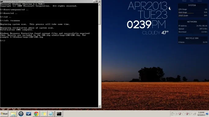

opened up cmd, ran sfc /scannow from C:\>
It's running. 1% complete, and waiting. 5% since I completed editing this post.

Attached, kindly find the sfc /scannow results.

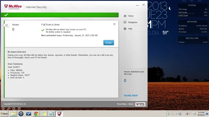

Also see attached screenshot of McAfee scan results.
