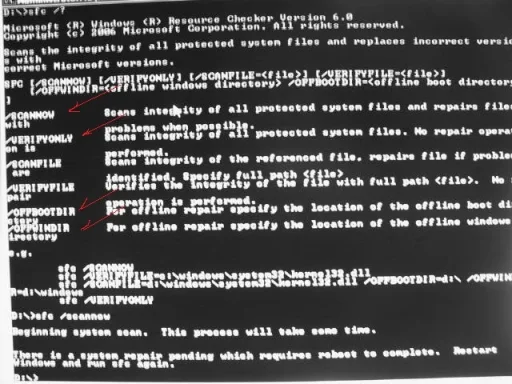

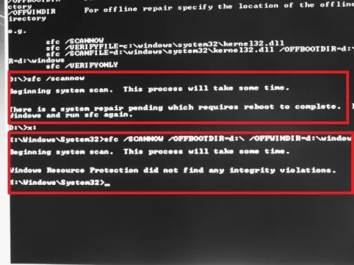

    I entered the repair environment and tried running the System File Checker to see what happened. As you can see from the attachments, I got the same response as you when just run from the command line. I typed in SFC /? to see if there were any switches that might help and found some to try.
    As you can also see from the attachments, running SFC using the additional switches allowed it to complete. Hopefully the same will work for you. But you need to know for sure where you Win 7 install is. If you have more that one drive, be careful, and make sure you have the right one. In my case, d: is the correct drive as I checked to make sure with the dir command showing the correct folders.
    I then typed in the command (copy and paste from the earlier printout) and did a /scannow with the additional boot directory and windows directory information. Let us know what happens with this change. You might also use the VerifyOnly switch since it does not attempt any repairs and may complete if the scannow does not. Be advised, it will take several minutes to complete and the only way I knew it was working was by watching the hard drive access light.
    Edit: I just checked my CBS.log, and perhaps it did not work as well as I first thought, but try anyway.
    Edit to the Edit: Although I was not able to get anything to work using the OffBootDir commands with /scannow, I was able to repair a file on another non-active Windows install, using the suggested command for repairing a specific file.
    sfc /SCANFILE=d:\windows\system32\xxxxxxx.dll /OFFBOOTDIR=d:\ /OFFWINDIR=d:\windows (d: being non-active install)

    I tried replacing ci.dll with the affected HD plugged in as an external, but the destination folder won't grant me access...
    I tried SFC with the new commands you proposed, but again i got the message about a repair pending and i needed to restart...
