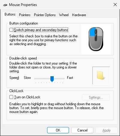

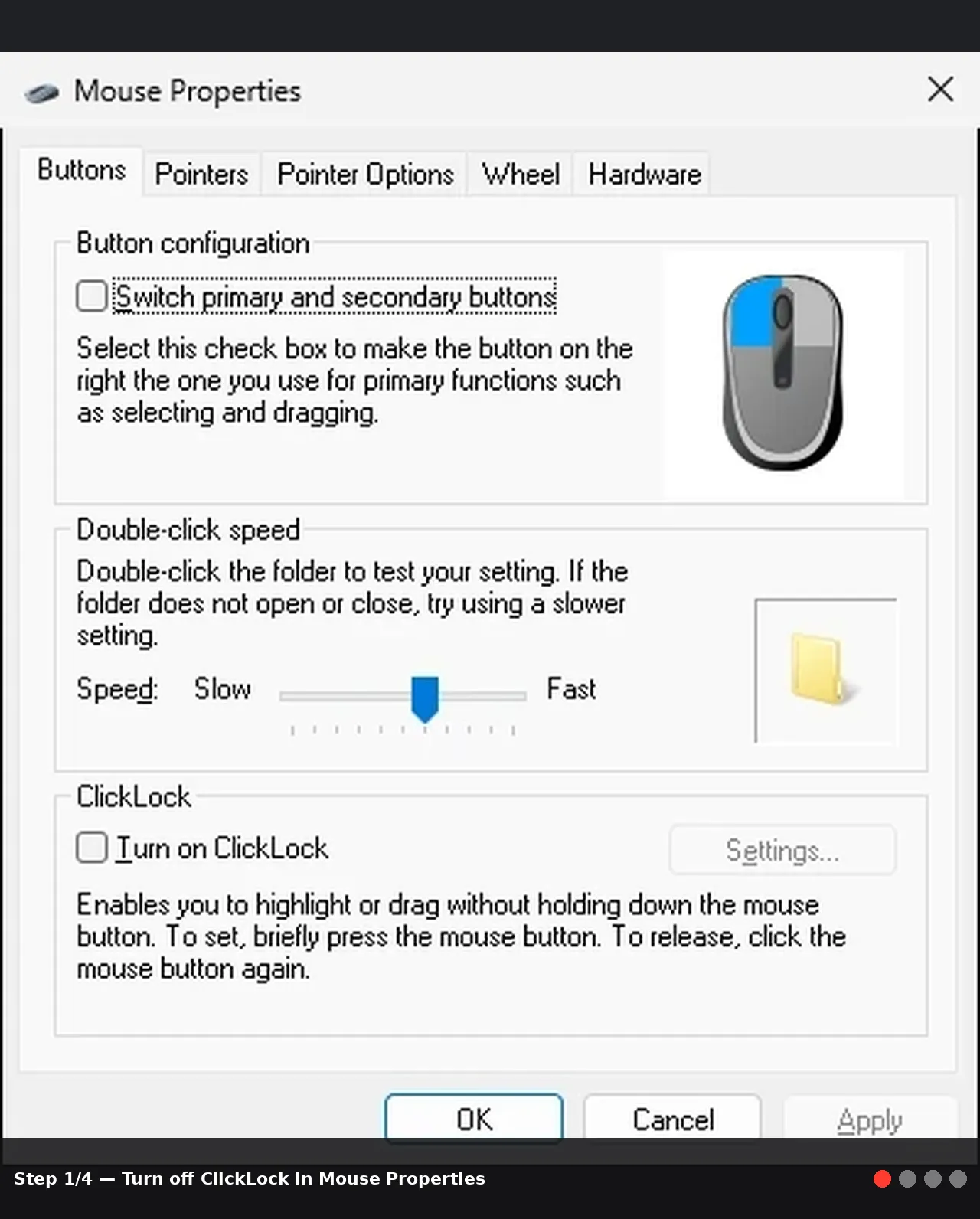

Turn off ClickLock in Mouse Properties​
The classic Mouse Properties dialog opens with tabs for buttons, pointers, pointer options, wheel, and hardware.
Microsoft Defender: No threats detected Scan details
ClickLock is an accessibility feature that lets you highlight or drag without holding the primary mouse button down. It is useful when intentionally enabled, but it can make Windows behave as though the left button remains pressed after a click.

  • Select Start > Settings.
  • Select Bluetooth & devices > Mouse.
  • Under Related settings, select Additional mouse settings.
  • In the Mouse Properties window, open the Buttons tab if it is not already selected.
  • Under ClickLock, clear Turn on ClickLock.
  • Select Apply, then select OK.
Windows 10​
  • Select Devices > Mouse.
  • Select Additional mouse options.
  • In Mouse Properties, select the Buttons tab.
You do not normally need to restart after changing ClickLock. Open File Explorer with Windows key + E, select a file once, then move the pointer without holding a button. The selected item should remain selected, but it should not follow the pointer or create a selection box.

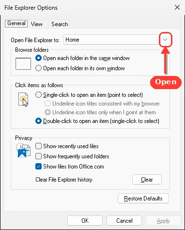

If folders and files open when you merely select them—but nothing is dragging and the mouse button does not appear stuck—File Explorer may be configured for single-click opening. This is a File Explorer setting, not a mouse fault.
Windows 11​
  • Open File Explorer with Windows key + E.
  • Select See more on the command bar, represented by three dots.
  • Select Options.
  • On the General tab, find Click items as follows.
  • Select Double-click to open an item (single-click to select).
  • Select Apply, then OK.
Windows 10​
  • Select the View tab.
  • Select Options, then select Change folder and search options if that second choice appears.
  • On the General tab, locate Click items as follows.
Test by single-clicking a folder. It should become selected but remain closed. Double-clicking should open it.

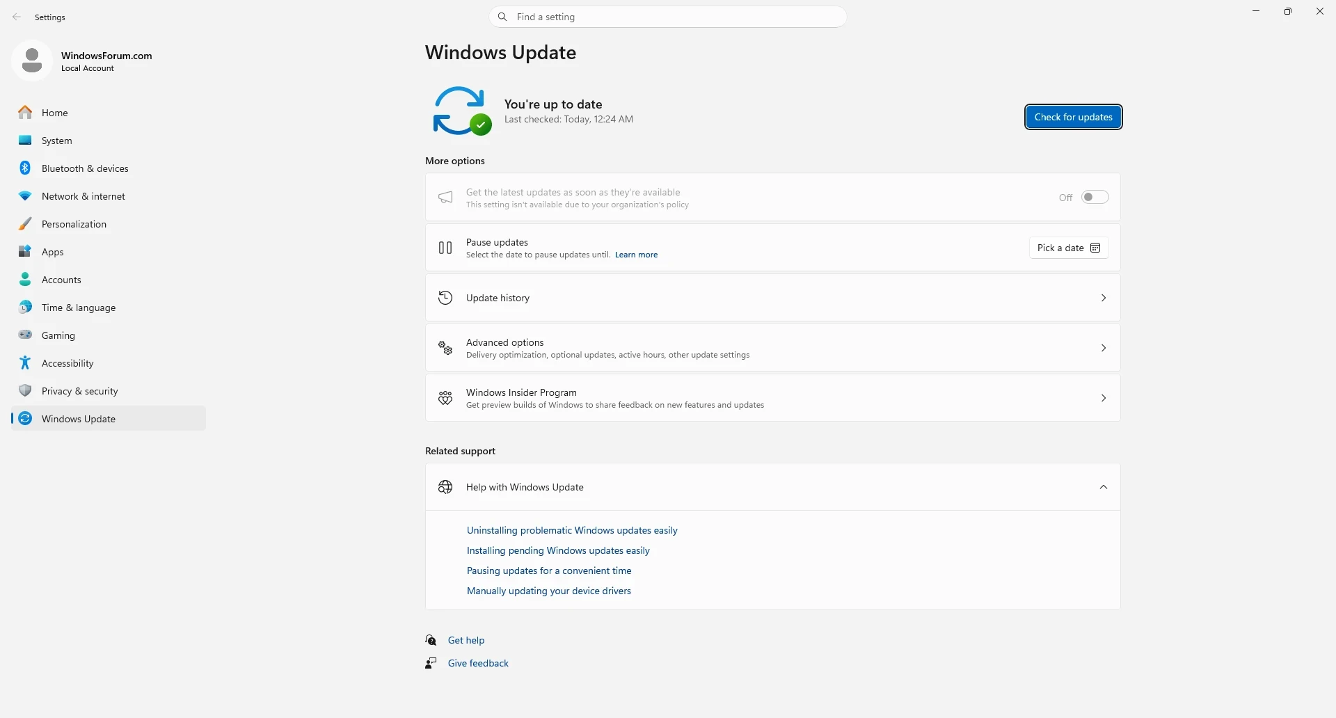

If the issue began after an update, after connecting a new device, or with no apparent settings change, install available Windows updates before attempting more invasive repair steps.
  • Open Start and type Check for updates.
  • Select Check for updates from the results.
  • Select Check for updates in Windows Update.
  • Install available updates.
  • Restart the PC if Windows asks you to do so.
  • Test the mouse or touchpad again after restart.

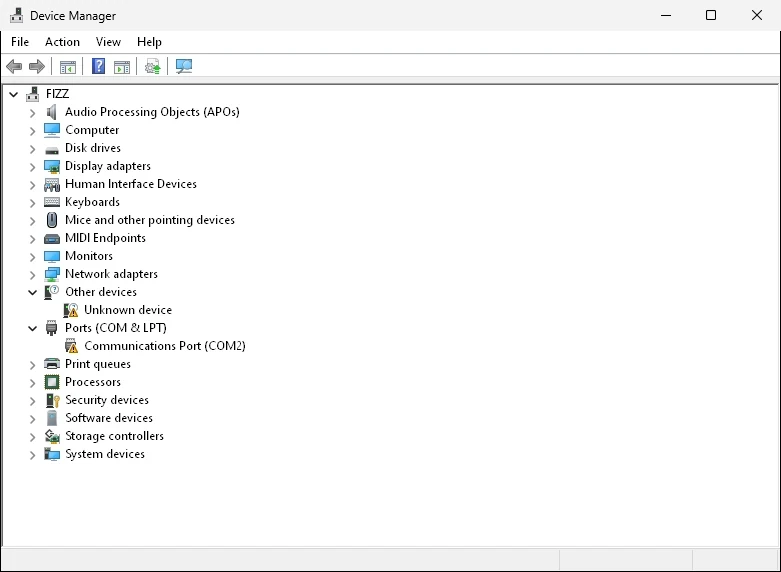

If Windows Update does not resolve an ongoing touchpad or mouse problem:
  • Open Start, type Device Manager, and select it.
  • Find the relevant device category, such as Mice and other pointing devices.
  • Double-click the device you want to check.
  • Open the Driver tab.
  • Select Update Driver and follow the prompts.
Device Manager showing the computer's hardware device categories in a tree.
For a laptop touchpad, prefer the driver supplied by the PC manufacturer when Windows does not offer an update. Touchpad features and gesture controls can depend on the manufacturer’s driver package.
