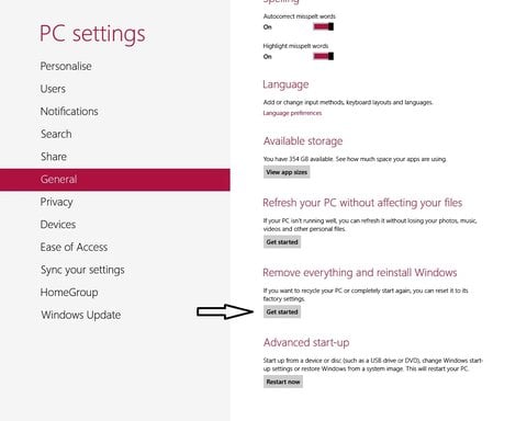

kemical
Essential Member
Member details
Aug 28, 2007
36,163
It's pretty important to have your windows installation syncing properly with your account. You'll probably lose some functionality too.
You could of course back up your files and reset the installation back to factory settings;
Link Removed
