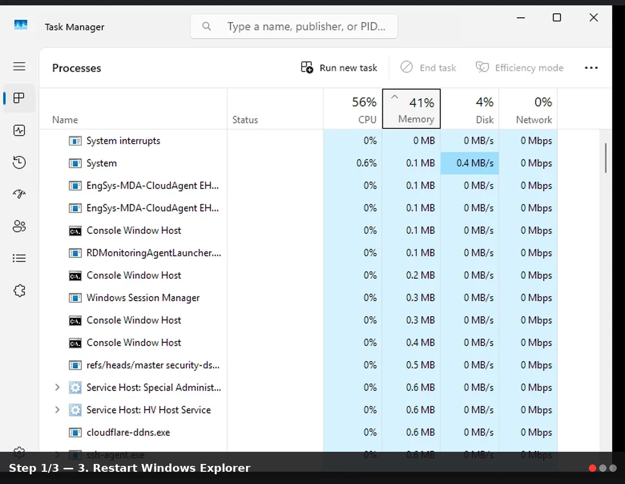

3. Restart Windows Explorer​
Task Manager Processes view with Windows Explorer visible.
  • Press:
    Ctrl + Shift + Esc
    This opens Task Manager.
  • If Task Manager opens in the compact view, select More details.
  • On the Processes tab, find Windows Explorer.
  • Select Windows Explorer, then select Restart.
  • On some versions, you can right-click Windows Explorer and select Restart.
  • The taskbar and desktop may disappear briefly while Explorer restarts.
  • Wait up to 30 seconds for the desktop, icons, and taskbar to return.
If Windows Explorer is not listed:
  • In Task Manager, select Run new task.
  • On older Task Manager layouts, select File > Run new task.
  • Type the following command exactly:
    explorer.exe
  • Select OK or press Enter.
Expected result: The desktop shell returns: wallpaper, taskbar, Start button, notification area, and desktop icons should reappear.
