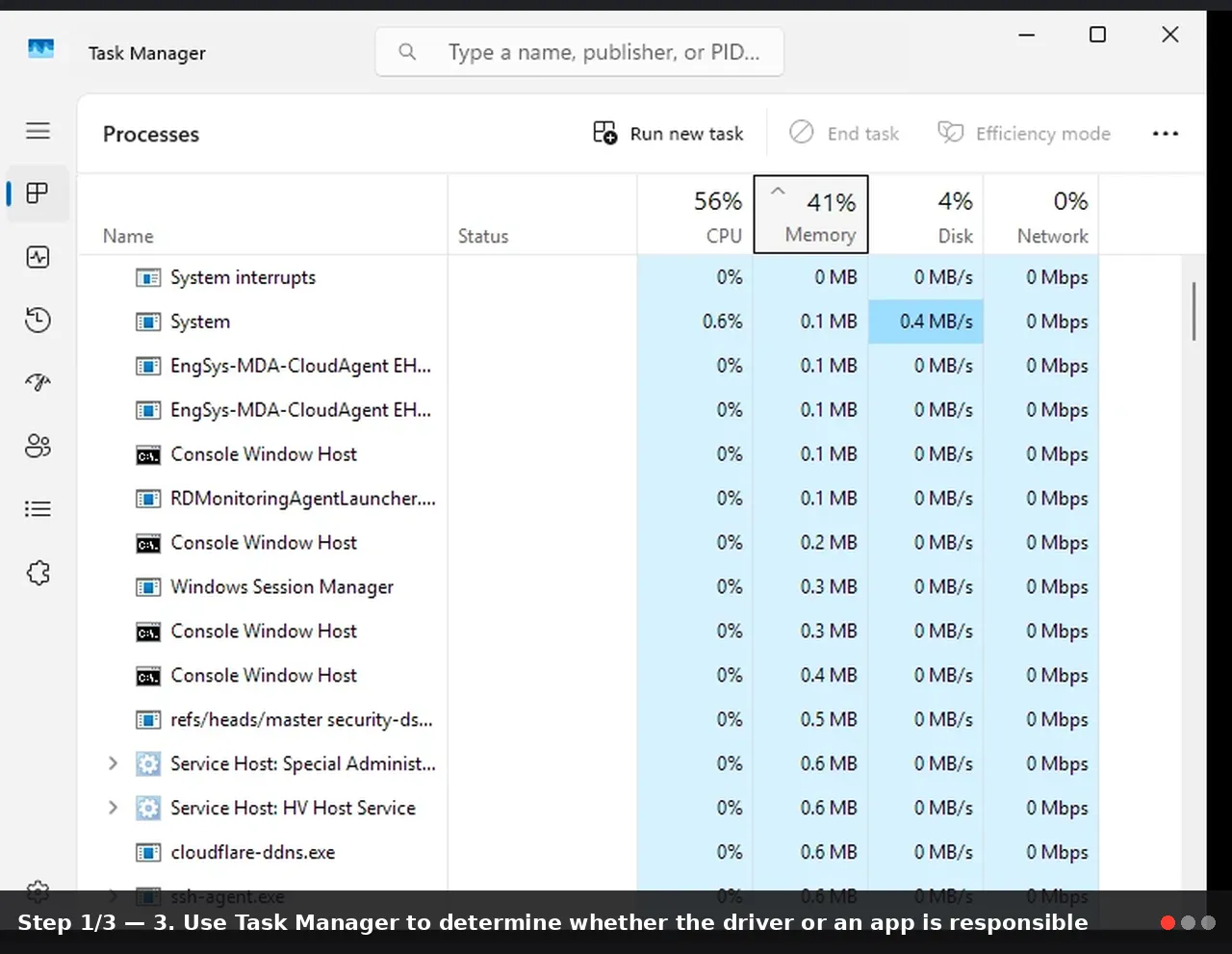

3. Use Task Manager to determine whether the driver or an app is responsible
- Press Ctrl + Alt + Delete.
- Select Task Manager.
- If Task Manager does not appear, press Ctrl + Shift + Esc instead.
- Watch Task Manager for 15–30 seconds.
Choose the matching result:
- Task Manager flickers too: Treat this as a display-driver problem. Continue to Step 4.
- Task Manager does not flicker, but the desktop does: Treat this as a likely application problem. Skip to Step 9.
