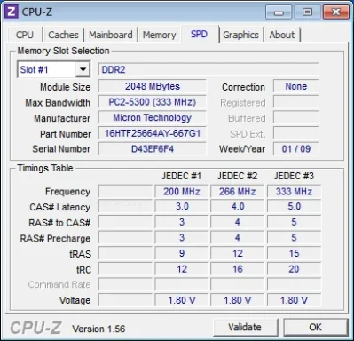

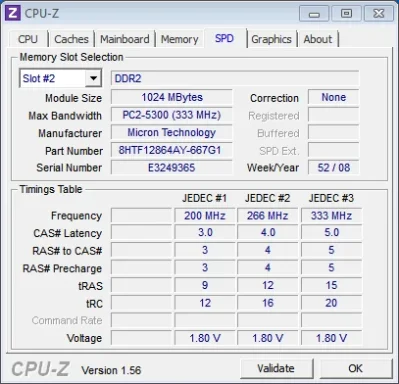

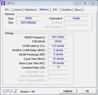

Give this info:
1. memory tab screenshot
2. spd tab of each RAM slot
Ok,
1. Timing Mode --> Auto
2. Memory Clock Value or Limit --> 667 (DDR 333 Mhz x 2)
After you adjust the settings, attach the CPU-Z tabs.
The only way I could get Memory Clock Value or Limit --> 667 was to change timing mode to Manual, I just wanted to mention I did do that and I am trying to still get the cpu-z and logs once I can get windows to stay on long enough to get them ran.

me said:
The memory timings are set right 5-5-5-15-20. However, the frequency is not. It is running at 200 Mhz while it should at 333 Mhz.
If the memory is still this way, it'll crash again.
