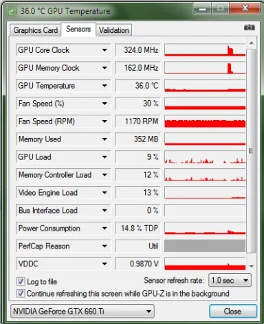

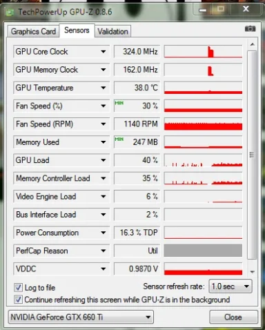

    Here is the sensor log.

    Your sensor log looks fine. Make sure your running the latest chipset drivers and remember my suggestion above to try downclocking your gpu simply as a test. As for removing the Realtek driver won't that remove your audio all together? You could try it I guess.

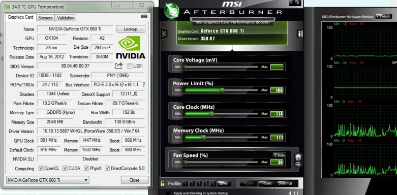

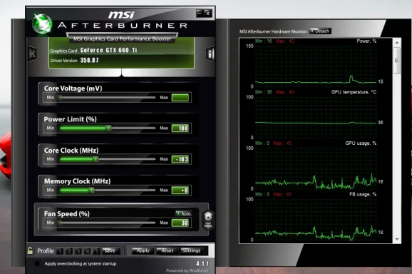

    Ok i turned my core clock to -103 clocking. Is this how you downclock it?
  8. kemical
    kemical Windows Forum Admin
    Staff Member Premium Supporter Microsoft MVP
    Joined:
    Aug 28, 2007
    Messages:
    32,087
    Likes Received:
    1,598
    Yes although I'm not exactly sure what 103 relates to.. Maybe megahertz? So you have basically taken 103MHz off the speed. You could always use GPU-Z to check although you'll have to make sure you know what the card is usually set at.

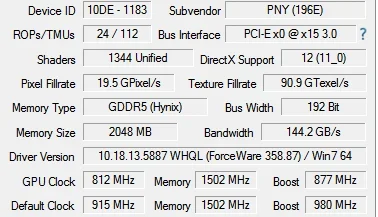

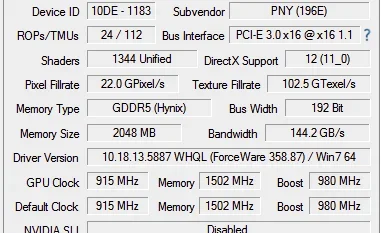

    So capture8 is what it is usually set at. taken yesterday and Capture 8.2 is after i changed it 10 minutes ago. And iin 8.2 more has the boost and clocking.

    Heres is the old boost and clock pic from yesterday

    Ok cool.. Looks like you've dropped the clock by 103MHz which is great. I see the boost is still enabled which might be an issue but see how you go.
  12. AirlessAlarm
    AirlessAlarm Active Member
    Joined:
    Oct 22, 2015
    Messages:
    117
    Likes Received:
    2
    How can i turn off boost?
