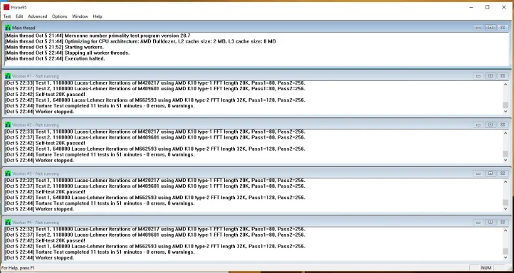

I ran Prime95 and it didn't crash/shut off my pc. Here's a copy of the results.
Ok that's something positive at least. Did the pc turn off with McAfee also and have you tried scanning in safe mode and see if the same thing happens? If it doesn't then it might be a driver issue.
