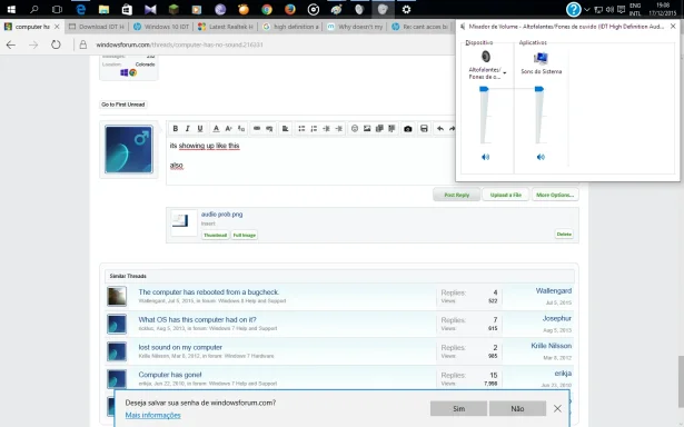

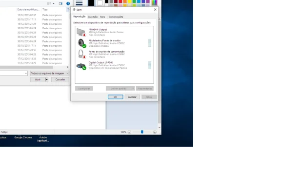

im trying to get into my bios to check if my onboard sound card is off but im having trouble doing it the option ofr firmware setting isnt there when i try the recovery method and the button timing thing isnt working for me, do you guys know why ?
Neemobeer
Windows Forum Team
Jul 4, 2015
8,998
I believe if it was disabled in BIOS it would not even show up in Windows.
what15
New Member
Dec 15, 2015
9
its showing up like this
also the speaker and headphones audio goes up normaly in the mixer though i cant hear it but windows system sound keeps still

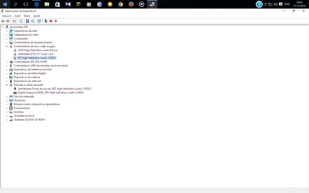

Can you post a screenshot of your Device manager with both "Audio inputs and outputs" and "Sound, video and game controllers" expanded
what15
New Member
Dec 15, 2015
9
here it is i have did the driver update thing and uninstalled and then rebooted,but to no use
Neemobeer
Windows Forum Team
Jul 4, 2015
8,998
It's really weird that it says CODEC, I think your driver is screwed up. Go to the properties for the IDT High Definition CODEC under audio input and output and roll back the driver, reboot and test.
