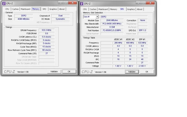

here are the screen shots you wanted.

Bingo. Problem found 100% so be ready to have an excellent working system. :)
Boot to the bios settings and Load the Optimized Defaults of the first page. Save and then make new screenshots to verify all is well. :)
Your memory is running overclocked by a lot and causing failures. This will fix it.
If you can't see Optimized Defaults anywhere, Load the Failsafe Defaults or any similar Default setting. Save.
Enjoy.

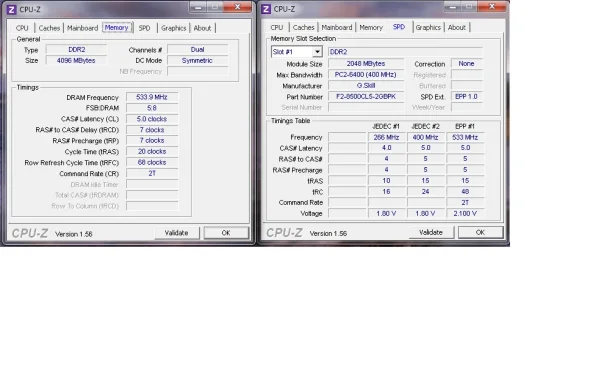

TorrentG
Banned
May 31, 2010
7,775
It is still overclocked, and prone to failure.
But...the memory can work well like this. All you need to do is go into the bios again and find the VDIMM (memory voltage setting.)
Set it to 2.1v and save. (It's probably at 1.8v now.) It will not crash like this and it will be overclocked and working well all at the same time.
Everything else looks perfect...just set that voltage as I've said. :)

Yep....at the end there....
DRAM
DRAM VOLTAGE 1.800V
Change the 1.800V to 2.100V instead. Save.

i changed it from auto to 2.100v it was purple when i selected it new cpu-z screen shot.
Let me know if its all Right.
edit
just noticed there is a slot 3 also in the spd but it says the same thing.
