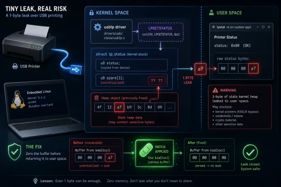

The vulnerable component is usblp, the Linux USB printer class driver. It exists to support USB printers through a traditional character-device interface, exposing operations such as status queries to user space. In this case, the relevant operation is LPGETSTATUS, an ioctl used to ask the printer for its status.The flaw is not a spectacular buffer overflow, a remote code execution primitive, or a privilege escalation with exploit code doing the rounds. It is an information disclosure bug caused by uninitialized memory. The driver allocated an eight-byte status buffer at device probe time, but did not initialize it before the first status query could be made.
That matters because the driver asked the USB device for one byte of status. If a malicious or malformed printer responded with zero bytes, the driver could still read from the buffer, treat the stale byte as status, sign-extend it into an integer, and copy it back to the calling user-space process. In plain English: the kernel might hand a local process one byte of whatever happened to be sitting in that heap allocation.
One byte will not dump credentials, bypass Secure Boot, or give an attacker root by itself. But kernel information leaks are rarely judged only by their size. They are judged by whether they cross a boundary that should be absolute: kernel memory should not be revealed to user space merely because a peripheral misbehaved.

The Fix Says More Than the Bug Report
The patch replaces an uninitialized heap allocation with a zeroed allocation. In kernel terms, that means usingkzalloc() rather than kmalloc() for the status buffer. The difference is simple: allocate memory and leave its old contents alone, or allocate memory and clear it before use.That small change is effective because the vulnerability depends on the buffer having stale contents before the first status read. If the buffer begins life as zeroes, then a zero-length response from a malicious printer no longer causes stale heap data to escape. A later short read may leave the previous device-supplied value in place, but that is not a kernel heap leak; it is just old device status being reused.
This is the kind of fix kernel maintainers like because it does not try to redesign an old interface. It preserves behavior for real printers, including badly behaved ones, while closing the kernel memory disclosure path. That distinction matters because the obvious fix — reject short responses — is not necessarily safe in the messy world of printer firmware.
The patch text makes that tradeoff explicit. Many printers are known to return “incorrect” responses, so strict validation could break working hardware. The kernel’s job, in this case, is not to make printers honest. It is to make their dishonesty harmless.

The concrete advice here is not exotic. Treat this as a kernel update item, not a board-level crisis. The systems most worth checking are the ones where USB peripherals and Linux meet in the real world.- CVE-2026-46167 affects the Linux kernel’s USB printer driver path, not Windows itself.
- The vulnerability can disclose one byte of stale kernel heap memory through the LPGETSTATUS ioctl when a printer-class device returns a zero-length status response.
- The upstream fix changes the status buffer allocation from an uninitialized allocation to a zeroed allocation.
- The most relevant systems are Linux machines with USB printer support, exposed USB ports, shared physical access, or roles as print servers and appliances.
- Administrators should rely on distribution or vendor kernel updates rather than guessing solely from upstream version numbers.
- The issue is best treated as a low-drama but real information-disclosure bug that belongs in normal patch cycles.
