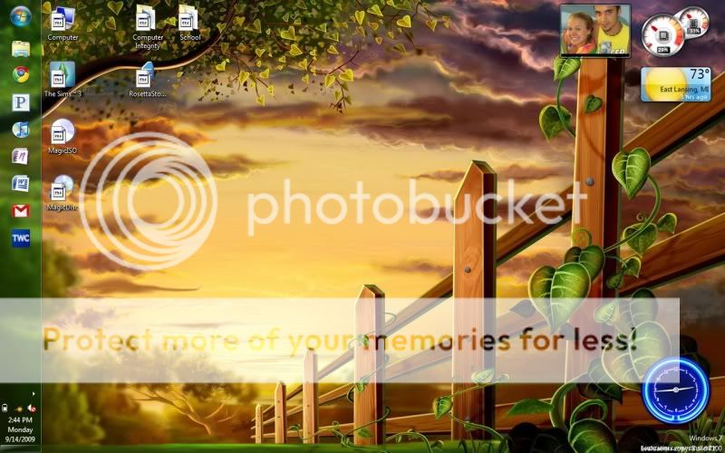

so i was messing around with taking the shortcut arrow off my desktop icons, but once i realized i couldnt drag and drop them to the super bar, i reversed my actions. i was left with an even bigger problem. all my icons display the "failed image" icon thing. i can't seem to figure out how to correct this. here, take a look at my screen shot.
Solution
Yeah.. you probably used a tool or procedure that used the old method that also removed the block around the text under icons. As you found out, that trick doesn't work... and causes problems under Win 7.
A program you can google called Windows 7 Toolkit 1.8 will remove the icons correctly.
I'm not sure how to reverse the action you took. If I find anything I'll be back.

ok, i tried that but after i hit enter after: DEL IconCache.db /a it says "file cannot be found" or something along those lines. any other ideas? thanks

When you say "super bar" do you mean the task bar? Looks like you just have the task bar located on the side.
