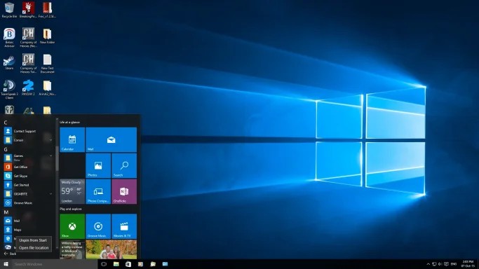

Edge has all of a sudden disappeared from my taskbar and I'm not getting the option to pin it back on..Same applies when I try and drag it on, it wont let me...No problem with pin to start menu.

Hey bochane the option isn there to unpin it from taskbar.Or pin it.Ive attached screenshot.

bochane
Essential Member
Oct 18, 2012
1,403
Sorry, I did not read correctly and was answering without thinking
The recipe is:
- Start up Edge, than it should appear on the task bar
- Right click the Edge icon on the taskbar and select Pin to taskbar
Again sorry for all misunderstanding I caused.
Greetings from The Netherlands
Henk
