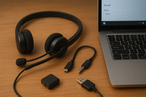

A black wired headset with a mic and USB adapters rests on a wooden desk beside a laptop.Background / Overview​

4. Use the correct adapter if needed:
  • TRRS → dual TRS splitter (female TRRS to two male TRS: green headphone + pink mic) — inexpensive and usually the cleanest fix for desktops with separate jacks.
  • USB audio adapter (USB → 3.5 mm combo) — bypasses onboard audio entirely and is a robust plug‑and‑power 10 recognizes as a USB audio device. This is the lowest‑effort solution if you don’t want to fiddle with front vs rear panel wiring.
