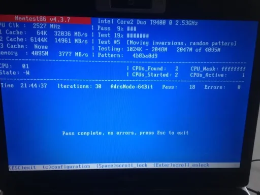

koen3950
New Member
Sep 16, 2014
11
Hello,
i finally found time to run memtest for a long time (21 hours). as far as i can see no problems detected ...

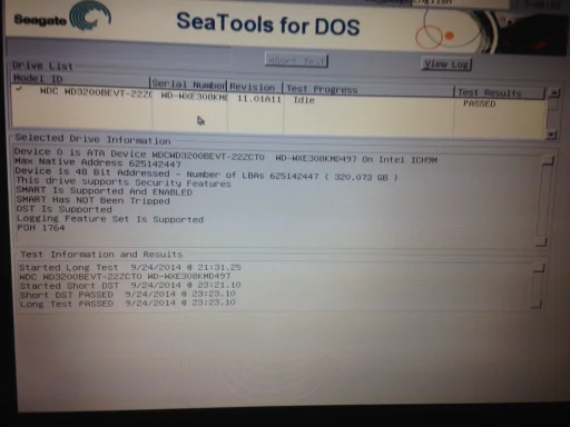

koen3950
New Member
Sep 16, 2014
11
I will try that later today or tomorrow! thanks.
I managed to run seatools yesterday in dosmode, it didnt find any problem (see attached screenshot).
thanks,
Koen
