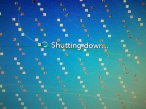

Anyways, i do the shutdown from start menu & it fails to shut down. When i left it for about an hour or so i came back & got this screen i have attached below, but doing the shutdown.exe /s /t 0 /f it shut down perfectly fine, so i have no clue what is causing the problem.
I did notice when i do shutdown from start menu i get 1 or 2 instances of waiting for background processes to close or sometimes my trillian before i get the shutting down screen, however doing the shutdown.exe /s /t 0 /f it did not do this & went right to the shutting down screen & then off.
So, this image got me worried because i dont know what is causing it. I know it can't be the GPU because my old GPU the HD5830 must of got heat damage & was causing visual distortions on my screen & flickering in games & on taskbar & browser bars, so my new HD7870 is brand spanking new & literally is less than 2 weeks old.
