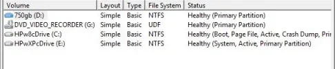

I have an older tower running W8.1 update 1 and Wxp - each OS is on a separate hard drive, when I boot the computer I get the choice of booting to W8.1 or earlier OS. I am now ready to remove the XP drive and delete all the information, my question is:
Is there a proper method to remove the choice of OS on the boot screen, or will it be removed if I just remove the hard drive with XP on it?
Thanks for your assistance.

You need to make sure where the boot files are. Could you attach a picture of your Disk Management window taken with the snipping tool? Attach using the upload a file button.

OK, here is the pic of the dsk mgt window.

This is not clear. Both system drives are active. To be safe, disconnect the XP disk and see whether 8.1 still boots. If yes, you can just delete the XP partition.
I assume that xp is on the e drive in that picture and that it has it's swap files on the c drive… ie Windows 8 is controlling the dual-boot interface. in this event just make windows 8 the default choice and the system will boot & adjust itself without the xp drive.
If for some strange reason you don't have windows 8 in charge but some legacy system like windows 7 or perhaps some Linux system was in there in the past then that will require extra steps but is still recoverable by booting into the windows 8 system recovery drive.
In any event it is simple enough to test safely as whs said by temp disconnecting the xp drive at the power or sata cable and see if the system will then boot up.

I guess I'm getting a little confused, my current setup is:
SATA 0 on MB is my 'HPwXPcDrive' drive
SATA 1 on MB is my '750gb drive' drive
SATA 2 on MB is my 'HPw8cDrive' drive
if I remove my XP drive and plug my W8 drive into SATA 0 on the MB I get an error on boot that says
NTLDR is Missing
Press Ctrl+Alt+Del to restart
is that what EasyBCD will add to the W8 drive once I remove "older OS from the boot menu?"
Thanks, Bob

Please clear up two points;
a. Did you set this system up… know what windows was installed first?
b. Is the windows 8 installed in legacy mode or is there an efi partition?
p.s. Yes that would give you an error because the boot drive is no longer in slot 3.
In Windows 8, the boot files are where the System is indicated, so they are on the XP drive.
Do you have Windows 8 bootable media to repair with if you were to need it?
If you are removing the XP drive and still showing the boot system is looking for NTLDR, you may need to run a bootsect /nt60 command. Hopefully the Repair on just the Windows 8 drive will repair that first, but it may take several runs for the system to be normal.
Since the Windows 8 partition is already marked as active, you should be able to do a startup repair and get your system setup. Make sure and remove the XP drive.
I had a situation, self inflicted, where I removed the boot files. The repair system did fix the problem, but did not know it had done so. If you get a message with a suggestion to Restore your system, cancel out and reboot, the system may boot normally.
You also have an option to use the bcdboot.exe utility to place the boot files, but if you were to do that, we will need to reset your Recovery options.

If I'm reading this right it shows Drive HPw8cDrive (C: as the boot drive, and the Drive with Windows 8 on it.
And HPwXPcDrive (E: as the drive with Windows XP on it, with no Boot Sector.
Link Removed
So once you have removed Windows XP from the boot list the computer should just boot into Windows 8 by default.
Some of the confusion is because when dual booting, which ever drive you boot into becomes the C:\ drive in Windows Explorer and Disk Manager.
It will also show as the System Disk depending on which one you are booted into.
But the image above shows that the boot sector is on the same drive as Windows 8.
Try using EasyBCD to remove Windows XP from the boot menu and see if it boots directly into 8 without a boot selection screen.
If it does then it's safe to remove Windows XP, but you can test this just by changing the name of the Windows folder for the Windows XP installation to Alt Windows when booted into Windows 8, you don't have to actually remove it to see if having it gone makes any difference.
Remember don't do this without removing it from the boot list first or you computer won't boot.
You would have to boot your computer into Ubuntu or something and change the name back.

The other images you posted show that the Boot Sector is on the Windows 8 drive too.
However as long as you don't delete it, it doesn't make any difference eitherway.
I have to admit that I'm surprised that it's shown on the drive with Windows 8, usually is will be on the drive with which ever OS was installed first.
Or did you add Windows XP after having Windows 8 installed?
Just don't format the XP drive and it will continue to read the boot sector where ever it is.
