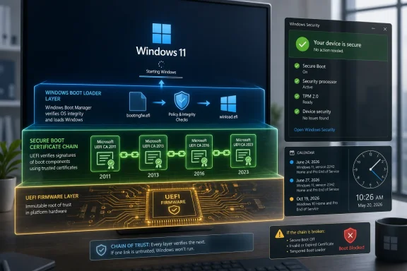

Microsoft’s original Secure Boot certificate chain begins expiring on June 24 and June 27, 2026, with the Windows boot-loader certificate following on October 19, 2026, but most Windows PCs will keep booting while Microsoft moves supported devices to newer 2023 certificates. The deadline is real, but the drama is easy to misread. This is not a Y2K-style cliff for old laptops; it is a security-maintenance handoff that exposes how much trust modern PCs place in firmware most users never see.
The practical story is less “your PC will stop working” than “your PC may stop receiving one class of future pre-boot trust updates.” That distinction matters, because Secure Boot sits below Windows, below your antivirus, below the cheerful lock screen where most users think security begins. If Microsoft’s migration works as intended, the average Windows 11 owner will notice only a green checkmark. If it does not, administrators and owners of older hardware will be left managing a slow drift into a less updateable security posture.
Windows 11 secure boot chain of trust diagram with Windows Security status on a desktop display.The Expiration Date Is Real, but the Panic Version Is Wrong​
Secure Boot arrived with the Windows 8 era as part of the industry’s shift from legacy BIOS to UEFI firmware. Its job is brutally simple: before Windows loads, the machine checks whether the boot components trying to run are signed by something the firmware trusts. That model was designed to make life harder for bootkits and rootkits, the kind of malware that wants to get control before the operating system has a chance to defend itself.
The certificates at the center of the current fuss were issued in 2011, which means they have quietly underpinned a huge chunk of the Windows PC ecosystem for nearly 15 years. Microsoft is now replacing them with 2023-era Secure Boot certificates intended to carry the platform forward into the next decade. The old certificates were never supposed to be immortal; the problem is that firmware trust chains age less gracefully than app updates.
The dates have become shorthand for a larger migration. The Microsoft Corporation KEK CA 2011 certificate expires first, followed by the Microsoft Corporation UEFI CA 2011 certificate in late June 2026, while the Microsoft Windows Production PCA 2011 certificate expires in October 2026. The difference between those certificates is not trivia for people who administer mixed fleets, dual-boot machines, servers, and virtualized workloads, because each certificate plays a different role in who gets to update Secure Boot databases and what boot code is trusted.
For home users, however, the most important point is also the least exciting one: expiration does not mean that a working PC suddenly becomes a paperweight. Existing machines are not expected to refuse to boot simply because a certificate’s calendar date has passed. The more serious concern is whether the machine can keep accepting the updated Secure Boot trust material that Microsoft and hardware vendors need in order to respond to future boot-level threats.
Secure Boot Is a Trust System, Not a Magic Shield​
Secure Boot is often described as a feature that “blocks malware before Windows starts,” but that phrasing makes it sound more autonomous than it really is. In practice, Secure Boot is a chain of trust anchored in UEFI firmware. The firmware maintains databases of allowed and disallowed signatures, and the system uses those databases to decide whether early boot software should run.
The moving parts have blunt names: the Platform Key, the Key Exchange Keys, the allowed signature database, and the disallowed signature database. The Platform Key establishes ownership of the Secure Boot configuration. The Key Exchange Keys authorize updates to the trust databases. The allowed database says what can run, while the disallowed database revokes components that should no longer be trusted.
That last piece is one of the reasons this migration matters. Secure Boot is not just about trusting good bootloaders; it is also about revoking bad ones. When a bootloader, shim, driver, or pre-boot component becomes exploitable, Microsoft and the broader ecosystem may need to push revocations so that Secure Boot stops trusting it. A PC that cannot receive those updates is not necessarily broken, but it is increasingly frozen in time.
This is where the old-PC framing becomes misleading. An unsupported machine may still run Windows, launch games, browse the web, and install ordinary security patches. But if its firmware and operating system cannot complete the certificate transition, its pre-boot trust store may no longer evolve with the threat landscape. That is not a daily usability failure. It is a slow erosion of a particular security layer.

The Windows Security Check Is Useful, but It Is Not a Full Audit​
Microsoft’s addition of Secure Boot certificate status to the Windows Security app is a good consumer-facing move. Users can open Settings, go to Privacy & security, launch Windows Security, and inspect Device security for Secure Boot status. A green result saying the required certificate updates have been applied is the answer most people want.
But the interface should not be mistaken for a complete enterprise audit. Administrators need fleet-level reporting, event logs, registry signals, firmware version data, and clarity about whether a device is merely capable of the update or has actually completed it. In managed environments, “it looks fine on my laptop” is not a migration plan.
There is also a subtle distinction between Secure Boot being enabled and Secure Boot being fully prepared for the certificate rollover. A PC can have Secure Boot on and still lack the newer certificates. It can also have Secure Boot off because a user disabled it for Linux, troubleshooting, GPU compatibility, or an old peripheral. Those machines are in different states, and a single “Secure Boot: On” line does not tell the whole story.
For enthusiasts, the temptation will be to dive into PowerShell, UEFI variable dumps, and firmware menus. That may be appropriate for experienced users, but it is not where the mainstream advice should begin. The mainstream advice is simpler: install current Windows updates, check Windows Security, check your OEM’s firmware page if warned, and do not randomly reset Secure Boot keys unless you understand the recovery consequences.
