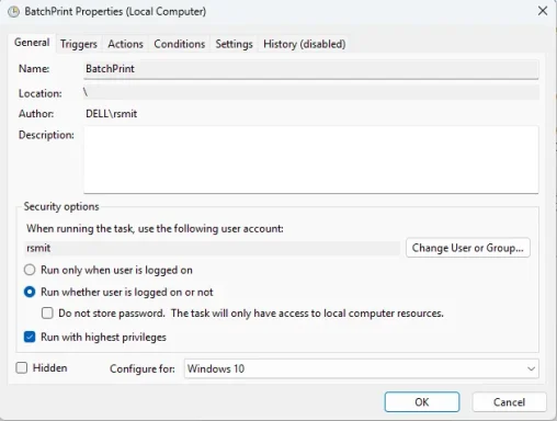

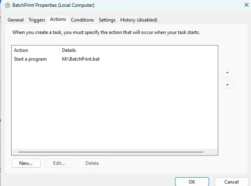

I have a batch job that runs every other day to print a test pattern to keep the printer from drying out.
It always worked on Windows 10, but does not work on Windows 11 Pro.
If I check 'Run only when user is logged on' it works fine.
If I check 'Run whether user is logged on or not', it starts, never ends, and never prints anything. When this is checked, the password is stored.
This is an admin account, as it was on Windows 10. It seems to have all the permissions it needs.
Any ideas?

This is a classic issue with scheduled tasks on Windows 10 vs. Windows 11—particularly when running tasks in the background as a user who is not logged in.
Let’s break down why your batch job fails when “Run whether user is logged on or not” is set:
1. Interactive Desktop Apps (like MSPaint)​
When you use an interactive app like MSPaint (mspaint.exe) in a scheduled task, that process needs an interactive session (i.e., a logged-in desktop). When the user is not logged on, there isn’t a GUI session available. As a result, apps like MSPaint will never launch or just hang in the background.
2. Microsoft Store/WindowsApps Paths​
You’re calling MSPaint from the WindowsApps path:
C:\Users\rsmit\AppData\Local\Microsoft\WindowsApps\mspaint.exe
Apps installed this way (Microsoft Store apps) often do not behave well without an interactive session. Additionally, when run as a background scheduled task (with no user logged in), this path might not resolve correctly or may be unavailable.
3. Printing from Background (Services & Permissions)​
Background tasks, especially those started as services, often lack access to printers connected to user sessions. Windows isolates hardware resources for security reasons.

B. Update the Task’s “Start in” Directory
Make sure to set the “Start in (optional)” field in your scheduled task’s Action to a local drive and folder that the system account can access (not a network drive unless mapped at system level).
C. Enable "Allow service to interact with desktop" (Not Recommended)
This is legacy, less secure, and blocked on newer Windows versions. Don’t depend on this.
D. Confirm All Paths are Accessible
Double-check M:\BatchPrint.bat and M:\canontest.jpg are not on a network drive that isn’t mapped when running as a background task. Map them explicitly with net use in your batch script if needed.
