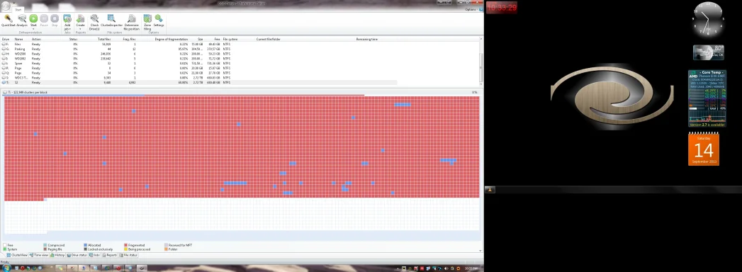

I just used the sync again to copy video files from one drive to a brand new clean, empty drive and I still got excessive fragmentation, as can be seen in the screenshot. It now seems clear to me that the only problem is with TI sync.

My only guess at a possible cause for that level of fragmentation is tat a large number of files is being simultaneously copied and the space required for each is not allocated up front so the files are being completely interspersed.

That sounds about right to me. I've about concluded that this is an unavoidable problem when using TI for this purpose, which is saddening. I did post a question about this on the Acronis Forum, in hopes of finding a solution, but I don't hold much hope of that happening.
That means that either I will have to do this kind of operation by manually copy/pasting, which I know works far, far better in this aspect, or will need to find another program that is able to do this properly...if such a program exists???
