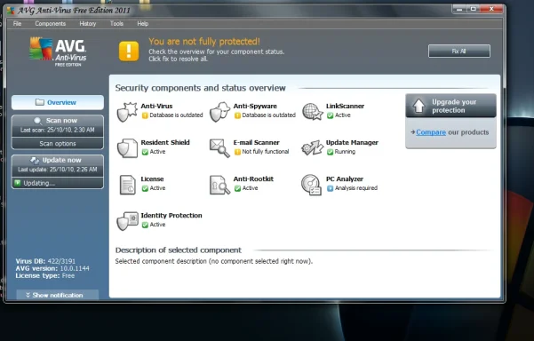

Now what the hell am i doing wrong?AVG also experience an error during installlation!What happen now?? :(

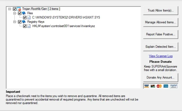

Hello again mike,okay..let me start this.Today i tried to install the avg thru safe mode and it succesfull then i tried to run it but it wont run even wont start after the reboot,then i tried again to uninstall it thru safe mode and i got this error
Link Removed
tried thru in normal mode still the same error.Gosh im bumped!
I dload the superantispyware and start the scan & the result below
Link Removed
even after the scan,the uninstallation wont success even run the program.

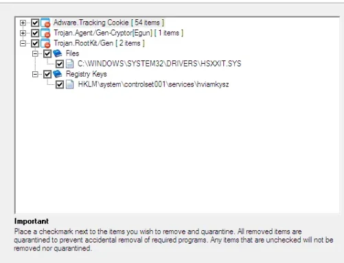

Hello People,Today i scanned my pc again with safe mode and found this
And again my 2nd scan in normal mode

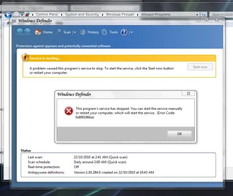

Also im facing some various problem especially my windows defender are not working anymore
defender problem.webpNOTE: When i ran rkill,the process terminate the c/windows/system32/dllhost.dll,Was it some kind of malware with that?

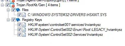

I just noticed that this one has caught my attention,When i do the 3rd scan the same threat was found,I did removed it with superantispyware & malwarebytes,But both still found the same threat like this.Any solutions to gettin rid of this thing?As i was reading some article in google this kinda a trojan would completely take over control my pc!Please,i need help for this,how to get rid of this moron completely?malwarebytes & SASPYWARE won't even remove it.
