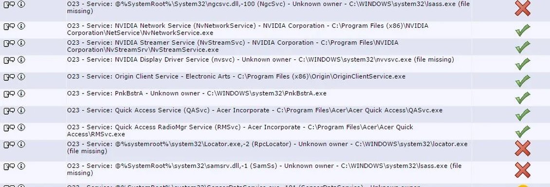

I did a Hijackthis scan and the Logfileresult showed some worrying entries

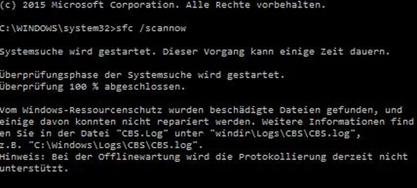

Laptop Crashed again.
it is in german, but here the report from the sfc scannow
( im sure you can read pass the german in this case )

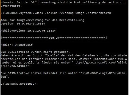

Error in the dism scan as well ( was over pretty fast )
Error Code : 0x800f081f
The Source Files could not be found.

kemical
Essential Member
Aug 28, 2007
36,176
Code:
*                        Bugcheck Analysis                                    *
Use !analyze -v to get detailed debugging information.
BugCheck EF, {ffffe0016f441780, 0, 0, 0}
----- ETW minidump data unavailable-----
Probably caused by : csrss.exe
Followup: MachineOwner
Hi,
the above Bugcheck means a critical system process died. Looking through I see that non of the changes I had suggested had taken place so please follow the instructions above and then if the machine bsod's after send me that dump file.
I'm hoping that changing your drivers will prove to be the solution although to be honest it's looking more and more likely to be the actual os and you may need to perform a reset. Anyway let's see how you get on after the above changes. I'm off to bed so won't be back until the morning.. Good luck! :)

I managed to fix the Problem. scf / scannow and Dism operates 100 %
had no carsh thus far
though I am still not sure if that was the origin for the BSOD crash?
doktajohn
New Member
Oct 12, 2015
7
Well yeah I ran an SFC Fix, provided in another forum. That made the Sfc Scan complete without finding any issues, thus made the DISM Scan possible without any errors.
Now since then the Computer did not give me the Blue Screen of Death.
