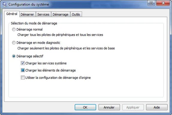

no dual boot, just Win7.
In MSconfig, i have unselect some files so in General, the last option is checked "selectiv boot"? (in french, démarrage sélectif").
For me too the are no sense for this f........grrr problem :/

This is what I have set. The first under General and then the startup tab. Other than this, I think you seem to be left with only a reinstall option!!
#17
Here my Msconfig for "General". There is a lots of apps in Boot tab but all is OK.
