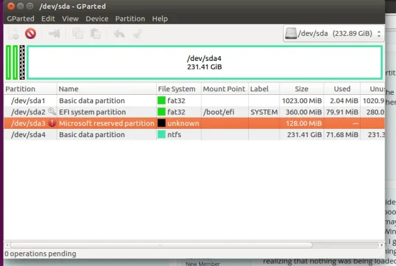

I installed Ubuntu using the "alongside windows for dual boot" option so I am no longer using a USB to boot Ubuntu, Since I can no longer boot windows I can only boot in Ubuntu. Neemobeer, I believe I started with MBR as the machine was originally strictly as Windows pc, however I believe I may have done something to format it as GPT, I had disabled Secure boot, inorder to open legacy booting. There is the option to run Windows boot manager but is essentially a dead end, if you look at the links I provided the youtube video covers all my booting options. I got a black screen with a bunch of code that made nonsense to me and furthermore would do nothing but repeat the code if anything was pressed, until i had to manually shut down, I had left it in that state for hours before realizing that nothing was being loaded.
here is also a screen grab of what my partitions look like in Gparted

ESP partitions can run on MBR or GPT partitioned disks, you can run the command gdisk /dev/sda to see if the disk is GPT or not. Your Windows install is setup to use an ESP partition which means you need secure boot turned on for Windows to boot. That would be the short answer why Windows won't boot.
You can fix this system as follows if it's an MBR disk
  • Go back in BIOS and turn Secure boot on
  • Boot to a Windows Recovery media (you can make this on any other Windows machine)
  • Boot to the recovery media and type bootrec /fixmbr
  • That should wipe out grub and replace the mbr with the Windows one and it should boot
  • Create a bootable Ubuntu installer with rufus, but use the UEFI partition scheme
  • Install the UEFI version of Ubuntu (this should happen automatically when secure boot is on)
That can't be the only hard drive, there're no Linux partitions at all. I'm guessing Linux is installed on /dev/sdb?

I have two hard drives in this Pc, a 250gb Samsung SSD and a 3 terabyte HDD that came with the computer, I got a special deal from costco for my HP ENVY Phoenix the exact model number is HP Envy Phoenix 810-430QE DT (KAILI2) *Whatever that last part means* I attempted the Sudo update-grub command line, it did whatever it was doing so I will post if that works. I would like to refrain from doing the Master BOOT Record Repair, unless my only other option is to go to a professional. I will also try enabling secure boot in the BIOS. When posting to the forum on the Ubuntu web page, one responder suggested that I actually had overwritten my windows installation with Ubuntu. I don't know if I mention previously that I have a windows recovery drive, that I got from the windows 10 media creator, is that the same thing as the ISO files/what I need to install? I booted from the usb containing this and tried to install from it, I got a message saying that I need to boot windows normally and then insert the usb, obviously I cant boot windows normally. I will also attempt turning secure boot back on and see if that yeilds any results and post with the outcomes.
the bad news is yes it does look as if you wipped the windows os but the key is still there (stored in the motherboard) so even if the recovery drive fails to restore things you can still download a free iso from Microsoft or pay for a recovery disc from HP... a professional that has dealings with HP may even have their iso disc already

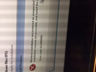

As I said, I would post the results, None worked, I will try removing and booting from a single harddrive and see how that works, I set the bios options back to default and reformatted most of my partitions as ntfs, , attempted the bootrec/fixmbr(no results) I no longer can boot into Ubuntu and if I start my computer with nothing plugged in then it says "boot device missing" visit www.hp.com/go/techcenter/startup which I found to be of little help, when I start my computer with the usb recovery drive it boots into it automatically, I went to custom installation and selected my 230GB ssd but it gave me some message about "Your partitions are not in the correct order, and not in the GPT format" so I went into the command prompt/terminal >Diskpart>list disk> select disk 0(since it matched the 230GB of my SSD) >Clean>Convert gpt>exit, when back to installing windows, that message did not appear this time although once the installation started I got the error code 0xC0000005 "Windows installation encountered an unexpected error, make sure the instllation sources are accessible and restart the installation process" I've attached an image with the error code message, it feels like I'm close to resolving/reinstalling windows 10. I appreciate your guys help and I think we will be able to fix this, My only goal now is to reinstall windows 10, I can worry about any potential data recovery later
I attempted the reboot, no success with the install. any suggestions? I've been searching for a solution but as of yet, I haven't found much that is of use.
