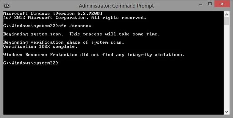

:) OK, I'll admit... You peeked my interest.
So I went ahead and restored the image from the 10th (prior to the latest round of updates) and that produced this (see attachment) when I ran the System File Checker
So I'm guessing that your original premise regarding those updates is probably spot on.
Regards
Randy

the update I believe to be responsible (KB2821895)
With that bit of information, I proceeded to install all critical updates to catch up my old image install to current status, excluding the update you mention above.
With everything up to date except the particular one I ran System File Checker again and again it finished finding no violations.
Then I installed KB2821895, which required a reboot and afterwards ran System File Checker again and all the previous errors returned.
So I guess that more or less confirms your suspicions.
Now to get my image that I created before all this started back on and I'll do the
dism /online /cleanup-image /restorehealth
Looks like we're not the only ones

Just a final report. Latest image restored, DISM utility ran, all good and well, SFC report no violations (again).
So that was fun. Was wondering what I was going to do with my Saturday. :)
