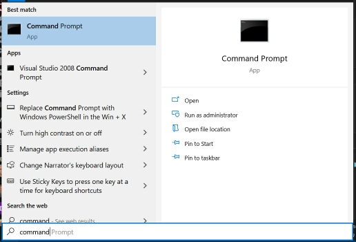

On the taskbar, on the left side, there is a search box. Write in it Command and the command prompt will appear somewhere above the search box. When Command Prompt App is displayed on the left top corner of the search app and it is already highlighted. On the right part of the search app window you will have different options (see attached picture), just pick the Run as administrator.

Yes, I can get to that screen but if I click Command Prompt it takes me to the prompt if I click Run as Administrator nothing happens.
