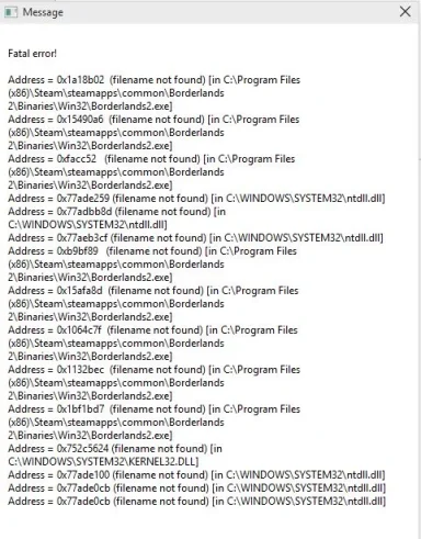

I suppose I will keep looking. Currently downloading the ESD so I can try a clean install. I have had numerous Blue Screens, it appears mostly related to Steam. But it says the server is busy, so it may be related to the network connection.

First, it looks like I have made progress on my Blue Screen issue. Setting Steam for Offline play seems to have helped. However, messages are still being sent to Microsoft every time I quit a game.
Edit: Well, I can play the game but still getting Blue Screens after shutting it down....

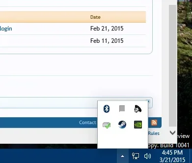

The icon for Defender is missing and Search are missing in Task Manager, and the Hidden Icons on the Taskbar. I believe I remember seeing a very dim Defender icon when I did the clean install but I think that was in Task Manger.
If I turn on show icon and notifications, the Defender icon shows on the taskbar, but not in the hidden icons box either way. But as I mentioned, I do get a mouse over message and can select the interface, I just can't see it.

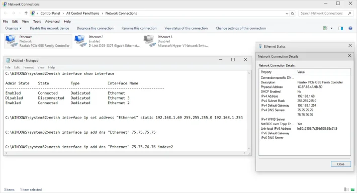

They have taken the problem a step further and a poster in TechNet says build 10049 has disabled the ability to adjust Network Adapter settings because those settings are being moved out of the Registry.
Using Netsh or Powershell may work, but some folks trying Netsh seem to find it does not work.
Trouble
Noob Whisperer
Nov 30, 2009
13,722
I was able to use "netsh" to set my IPv4 static addressing on my primary Ethernet adapter.
What a PITA.
God, I wish they would stop shooting themselves in our foot.
Can't imagine what frustration there might be for someone without a DHCP server or some other DHCP service related problem.
