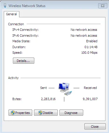

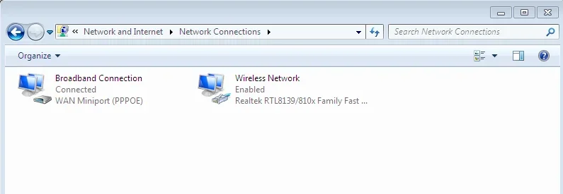

Problem No.1 - Where did my wireless networks go?
After installing Windows 7 I used an ethernet cable from my router to my computer and installed all of the updates. Once the updates were installed I was able to see the available wireless networks to join. Hooray I thought she is up an running with a wireless connection just as before with OS XP.
After trying to connect to my wireless network, within minutes the computer ran a troubleshooting diagnostic and said it fixed the problem. The fix was that I was no longer able to view or access the wireless networks. Poof - they just disappeared. So now I have to sit very close to the router and keep the ethernet cable plugged in to access the internet, which means now other computers can not access the network because I have the cable connected to my computer.
Problem No.2 - This occuured after fiddling around trying to fix Problem No.1
Although I am currently able to access the internet through an ethernet cable only - I have big red x reading "not connected - no connections available"
Please find a few screen shots below and ipconfig details below
Please help, as I am clueless and exhausted :frown:

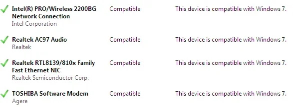

Hello ickymay,
Thank you for your reply. I have updated the drivers, ran windows 7 upgrade and bios. See attached.
wireless compatible.webpCan it be a simple setting? Is there a 3rd program that can manage my networks and internet connect?
Hello ickymay,
View attachment 5503Can it be a simple setting? Is there a 3rd program that can manage my networks and internet connect?

ickymay is correct, you shouldn't need a third party network manager to resolve the issue. It looks to me like you may have possibly configured the Windows 7 machine to host and negotiate your PPPoE connection and that may be the actual cause of the problem. If your ISP uses PPPoE and requires a username and password for a connection, then you would probably, be best served by embedding that information on the router, rather than the Windows 7 machine. Maybe take a look at this thread and see if it helps
Link Removed
