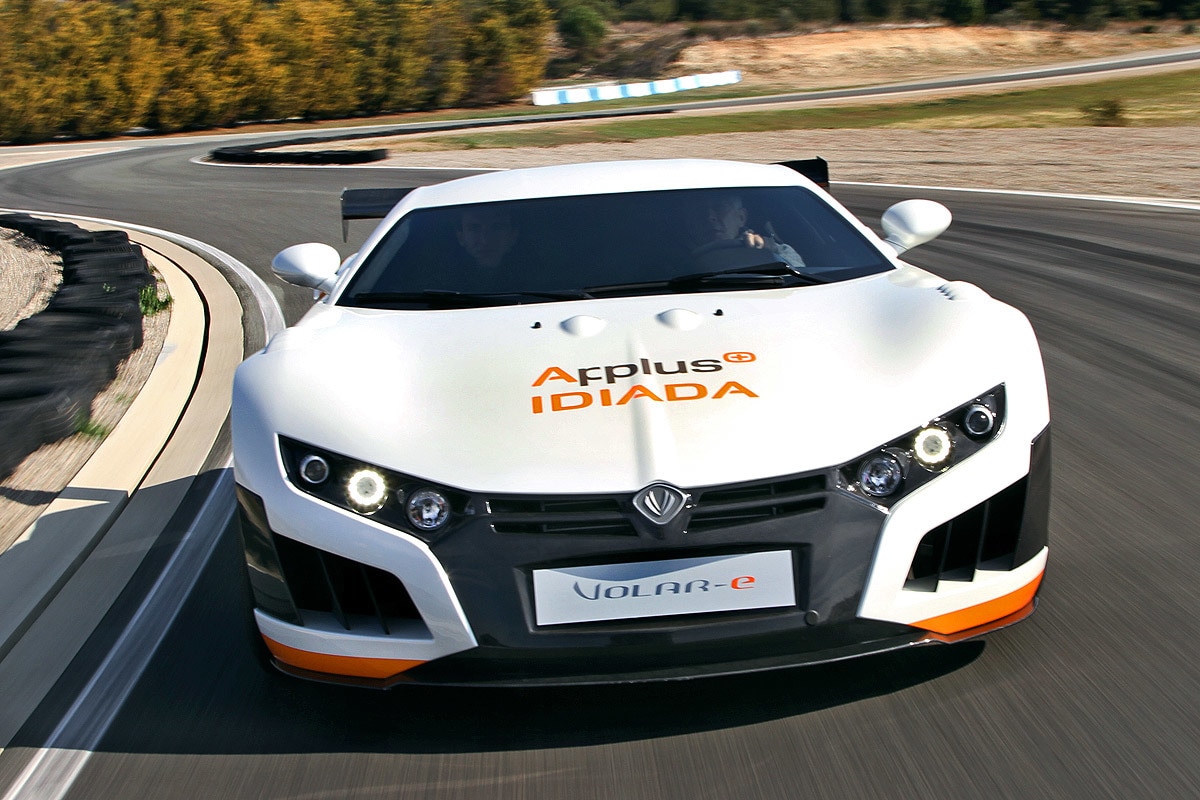

Applus Idiada showcased the Volar-e at the Circuit de Catalunya outside Barcelona earlier today, presenting a four-motor electric concept with a claimed 1,000 horsepower, 737 pound-feet of torque, a 38-kilowatt-hour lithium-ion battery, and a special fast-charge time of 15 to 20 minutes. Despite the Tesla-shaped framing that accompanied some discussion of the car, the Volar-e is not a Tesla product, preview, or announced production model. It is a European-backed technology demonstrator developed by Applus Idiada with Croatia’s Rimac Automobili—and its most important specification is the one its makers did not provide: driving range.
The Volar-e therefore lands as two stories at once. It is a spectacular proof that electric propulsion can deliver supercar power, but it is also a reminder that dramatic acceleration and a short laboratory-style charging claim do not, by themselves, answer the questions that determine whether an electric vehicle can become useful commercial transportation.

The headline figure is a claimed combined 1,000 horsepower, accompanied by 737 pound-feet of torque. That output comes from four electric motors, creating a layout that potentially allows propulsion to be managed independently at each wheel rather than distributed mechanically from one engine through a conventional transmission and differentials.
That architecture is more significant than the round-number power figure. A 1,000-horsepower claim is excellent publicity, but four independently controlled motors point toward an entirely different way of making a high-performance car corner, accelerate and recover stability.
An electric motor can respond quickly to changes in requested torque. Put one at each wheel, coordinate them through software, and the powertrain becomes part of the vehicle’s active handling system. Instead of merely reducing engine output or applying a brake after a loss of traction is detected, the controller can potentially alter the driving force at individual wheels.
Green Car Reports highlighted the torque-vectoring possibilities of the four-motor system, describing a car able to vary power across its wheels for greater control through corners. The practical value is not limited to lap times. The same underlying idea can support traction management, stability intervention, regenerative braking and more precise control on low-grip surfaces.
This is where the Volar-e looks less like an isolated publicity stunt and more like an engineering preview. The path from a track demonstrator to a road car rarely involves transferring every specification unchanged. It more often involves taking the control strategy, thermal knowledge, power electronics or motor-management techniques and adapting them to a less extreme product.
Applus Idiada claims the Volar-e can accelerate from rest to 62 mph in 3.4 seconds and reach a governed top speed of 186 mph. Those numbers position it in supercar territory, but they also expose an interesting tension: the car has much more headline power than its acceleration time alone might suggest.
