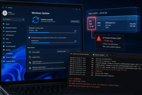

The Failure Is Small, Hidden, and Perfectly Windows
The awkward part of this update failure is that the machine can look healthy from every ordinary angle. File Explorer may show hundreds of gigabytes free on the main Windows volume, while Settings may report no storage pressure at all. The failing component is not C: drive space; it is the EFI System Partition, the tiny boot partition created during installation and usually hidden from view.That distinction matters because users tend to understand storage as one big bucket. Windows, however, is a stack of compartments, and modern servicing increasingly needs to touch boot components as well as the operating system files that live in plain sight. When that hidden partition is too cramped, the update can get most of the way through staging, reboot, try to service boot files, and then trip over a few missing megabytes.
Microsoft’s documentation says affected devices may log messages in
C:\Windows\Logs\CBS\CBS.log pointing to insufficient free space, failed boot file servicing, and third-party or OEM files outside Microsoft boot directories. That last clue is important. This is not simply a case of Microsoft shipping an oversized package; it is also a reminder that OEMs, recovery tools, security products, Linux dual-boot setups, and vendor utilities have all treated the EFI partition as convenient real estate.The result is a very modern Windows failure: technically precise, visually vague, and easy to misdiagnose. Error 0x800f0922 has appeared in multiple Windows Update contexts over the years, so its presence alone does not tell an administrator “your ESP is nearly full.” The real diagnosis lives in logs most home users will never open.

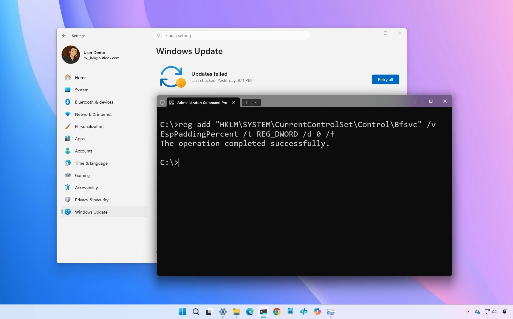

The Registry Workaround Is a Scalpel, Not a Consumer Ritual
Microsoft also describes a direct workaround involving theEspPaddingPercent registry value under HKLM\SYSTEM\CurrentControlSet\Control\Bfsvc. The command sets that value to zero, reducing the reserved padding Windows uses in the EFI partition during servicing. After a restart, the affected system can retry KB5089549.That fix is useful, but it should not be mistaken for a casual tweak. Registry edits are not magic incantations; they are configuration changes aimed at a specific servicing behavior. Used on the right machine, with the right symptoms, they may get the update through. Used blindly, they add one more unexplained change to a system that may already have a complicated boot layout.
For enthusiasts, the temptation is obvious. A one-line command feels cleaner than waiting for Windows Update to sort itself out. But the presence of an official command does not mean every failed KB5089549 installation has the same root cause, and it certainly does not mean every user should start manipulating boot-servicing parameters after one failed attempt.
The more responsible sequence is boring. Reboot first. Check Windows Update again. Confirm the device is actually on Windows 11 24H2 or 25H2 and actually failing KB5089549 with 0x800f0922. If the problem repeats, inspect the CBS log or use administrative tooling to check EFI partition free space. Only then does the registry workaround belong in the conversation.
The EFI Partition Has Become the Junk Drawer of the PC
The EFI System Partition was supposed to be infrastructure: small, specialized, and mostly invisible. It stores bootloaders and related files that firmware uses to start operating systems. On many Windows PCs, it is measured in hundreds of megabytes, not gigabytes, because it was never meant to become a general-purpose storage area.Reality has been less tidy. OEM diagnostics, recovery components, firmware update helpers, third-party boot managers, and multi-boot configurations can all leave artifacts there. Some may be necessary. Some may be stale. Most are opaque to the average owner.
This is where Microsoft’s wording about third-party or OEM files outside Microsoft boot directories becomes more than a log message. It hints at an ecosystem problem. Windows owns the update experience in the user’s eyes, but it does not always own the historical contents of the partition that the update now needs to use.
The industry has seen this pattern before. A reserved partition that looked generously sized in one era becomes cramped in the next because security requirements changed, servicing became more sophisticated, or hardware vendors used the space differently than expected. The users who pay the price are not doing anything exotic. They are running ordinary machines that accumulated ordinary vendor choices over time.

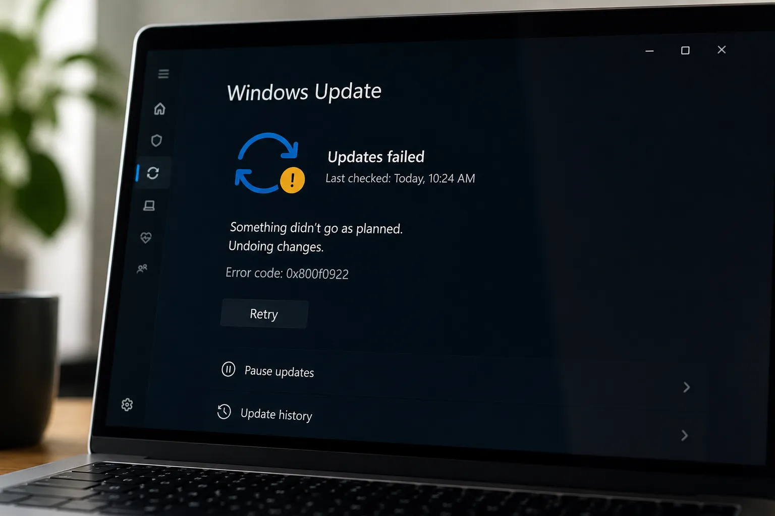

The Error Message Still Refuses to Tell the Truth
“Something didn’t go as planned. Undoing changes.” is the kind of message that proves Windows can recover while still failing to communicate. It is reassuring in the narrow sense that the system is not bricked. It is maddening in the broader sense because it hides the one fact the user needs: this failure may involve a hidden boot partition, not normal disk space.Microsoft is not alone in softening technical errors into friendly language. Apple does it, Android does it, browser vendors do it. But Windows Update occupies a different role in business environments, where a vague rollback is not just a user annoyance but a patch-management event.
A better experience would not dump raw CBS log lines onto the screen. It would identify the class of problem after rollback and point users toward a safe next step. If Windows can detect insufficient EFI partition space in logs, it should be able to surface a meaningful diagnosis in Windows Update history or Reliability Monitor.
This matters because vague update failures create bad folk medicine. Users will run random cleanup tools, delete SoftwareDistribution folders, disable antivirus, uninstall drivers, or try offline installers without knowing whether any of those steps addresses the actual constraint. The machine may eventually update, but nobody learns why it failed.
