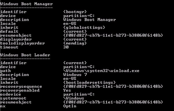

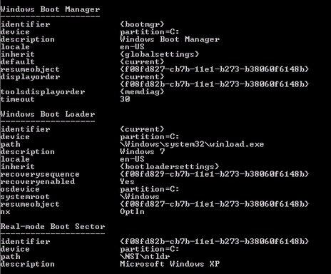

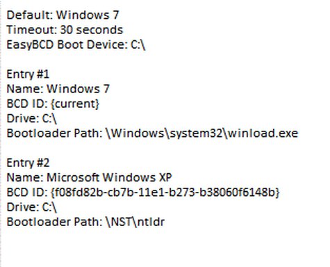

Well, leejosepho, looks like you were right on many of your points.
There is a NST folder created with either ntldr or easyldr1, depending if you let EasyBCD Auto find the install, or manually find the install partition.
The EasyBCD version of ntldr is 290K where the original ntldr is 248k, so something has been added. That larger version replaced the original ntldr in the root directory and placed in the NST folder.
The original Boot.ini file is replaced by a special one made by EasyBCD. And perhaps this part is where the problem arises when you match different versions with different ntldr versions.
I did not have the problem with an invalid boot.ini prior to using EasyBCD or after. Had I started changing things around, I may have run into it.
You can notice from the attachments, the version of ntldr used is the one in the NST folder. If you change the one in the root directory, it might be used in the case of booting directly to a drive instead of using the dual boot menu. But I am just guessing something gets out of sync.
