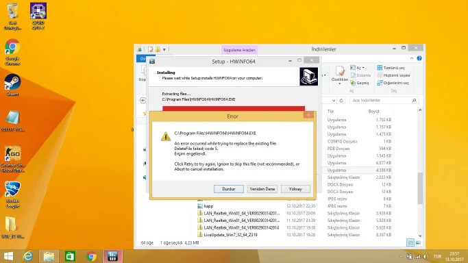

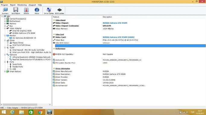

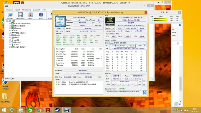

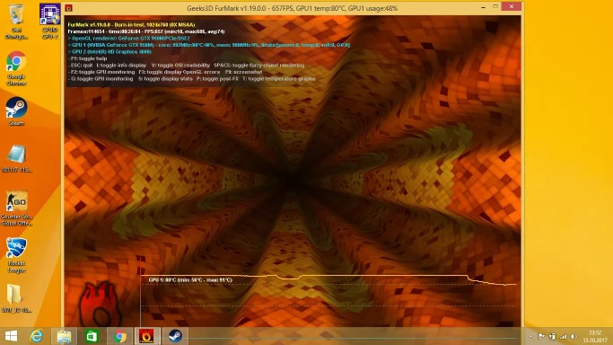

OKAY GUYS HERE ARE THE RESULTS...
THE CANT BE REACHED ERROR İ GOT WAS JUST BEFORE THE BSOD HAPPENED İT WOULDNT LET ME REINSTALL HWINFO..

İ ran the furmark and it bsoded..
If you notice in your screenshots, just prior to bsod, your gpu temp is 80c although it had reached a max of 91c :
An image from 'Wi̇ndows 8.1 Bsod After Turning On The Laptop'. GPU temperature display showing current 80°C, min 56°C, max 91°C.
Are all the vents free from dust? Try using a small brush or compressed air to blow them clean.
Are you sure you downloaded the correct version? If your using 64bit windows then you'll need the 64bit version.
