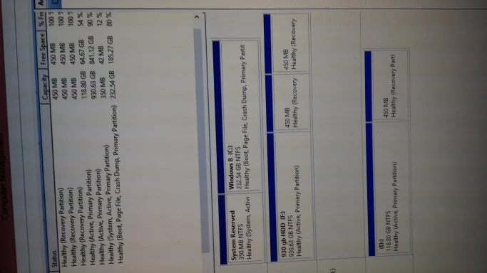

I don't know how to take a picture of the disk management screen
Here (I think) is a picture of the Dist Management screen. After everyone feeling fairly certain there is no problem is have both system disks attached at the same time, I now have both. Disk C is Windows 8.1 (on a 256gb SSD) and Disk D is Windows 10 (120gb SSD, build 10074). I also have a 1Tb conventional HDD Disk F. I will run with both attached for a while and hope both stay pristine! Thanks guys, and let me know any thoughts.

Open Disk Management, diskmgmt.msc, and take a picture using the snipping tool. Or you can use the Winkey+X menu, or right click in the lower left corner of the desktop and select Disk Management.

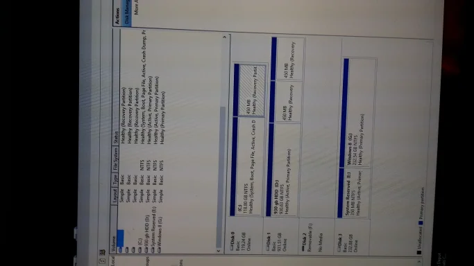

I took a photo of it. Click on the file to view it. Thanks, and see the note above!
You have a Legacy install, so any mentions about UEFI are not relevant.
You have two active partitions, so the boot files may be in separate partitions, or they may be in the one currently designated as System. But I have not seen a Legacy install have boot problems. Do you know why you have two active partitions?

No, I just built each system (8.1 and 10) separately with the other disk not connected (so one disk at a time), then connected both. Luckily, in spite of the "scanning and repairing drive (D:):", the one with Windows 10 on it, when I booted Windows 8.1, Windows 10 booted up just fine. Attached is the Computer Management screen now, with Windows 10 running. Thanks for your caring and help!
It MAY be that there is an active partition on the 1Tb drive because I use this for "file backup". It has no system on it.
