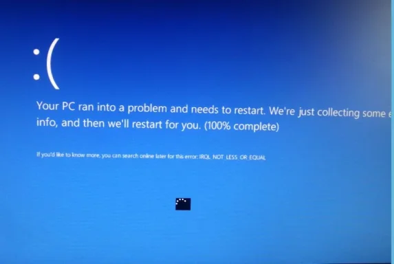

Hello everyone. I have a PC that I built a few years back, which is a decent PC. As of lately, I've been getting BSOD. I bought a copy of SimCity and it started then, but now even when not playing SimCity I get them! I'm getting the following BSOD:
  • PFN_LIST_CORRUPT
  • DRIVER_CORRUPTED_EXPOOL
  • ATTEMPTED_EXECUTE_OF_NOEXECUTE_MEMORY
I searched around and saw that it's possibly my memory? So I took out one module and the PC wouldn't even turn on. So I switched it with the other module and it turned on. Both turned on just fine together. I don't know anymore if it's memory related. I ran a windows memory test, and it said everything was fine at the moment. I've also done disk checks (on both my SSD and my HDD) and came back with flying colors.
I read the MEMORY.DMP with the windows tool and I see this: DEFAULT_BUCKET_ID: WIN8_DRIVER_FAULT
I'm attaching the files asked for to this post.
Thank you very much for your help! It's greatly appreciated.

:'( It's done it again. 99% of the time, it's while I'm playing SimCity! Could it be a problem with the game? Or some kind of setting for the graphics card or something like that? It gave the error : KERNEL_SECURITY_CHECK_FAILURE.
Then it turned off, restarted but only the fans turned on. I had to manually power down the PC and let it rest for like 2 -3 minutes, because every time I turned it on, it just spun up the fans and nothing turned on the screen. But after waiting, I was able to boot up.
Thank you for your continued help...

Another add:
I noticed I can't put my device into sleep mode! Some driver is acting up, I imagine... It sleeps, but it keeps the fans and lights on. But I have to force restart or shutdown the PC, but when it turns back on, it thinks it's waking up and continues on from where it had left off! Strange.
I also checked, in my bios it says it's working in AHCI... So that's good.
