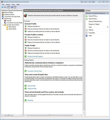

I was involved with a thread just recently that seemed to have the exact same problem. Changing Advanced Sharing Settings would not stick.
It turned out many of the rules in the Windows Firewall that allowed such things as Network Discovery were missing so could not be changed. You might check the rules on the firewall and see if you have many (around 25) rules for Network Discovery. Some are for the private networks and some for public, etc. (fw.msc)
I never found out what actually removed the rules, but the poster imported the rules and repaired the problem.

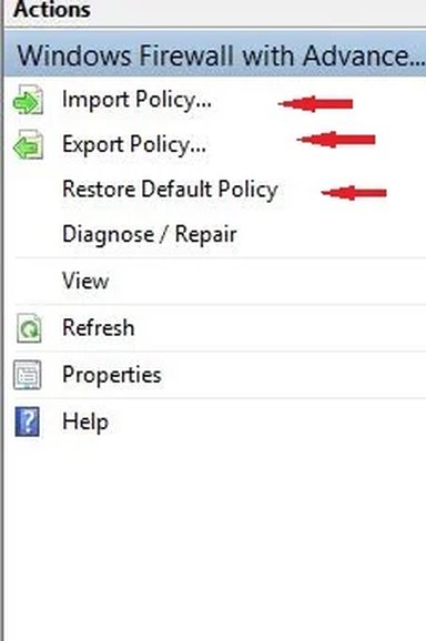

SUCCESS!!!!!!!!
I did some Googling and found a forum reply that said "The problem was resolved by importing a policy exported from a working Windows 7 computer.
So I went to one of my other PC's and looked and sure enough it had the FW on and could network and file share!
I exported its policy to the failing PC desktop (its fire wall was off). Went to that PC and in FW advance settings imported the policy.
BAM!!!!!!!!!!
BAM!!!!!!!!!!

No.......... I did not mention it but I tried that and got the same error as mentioned in that thread, when choosing to restore defaults It came back - Windows Firewall could not restore the default policy, error:3.
I cannot tell you the head banging I did before posting here and I did Google it but missed it until this evening.

It would be very good if you happen to know what removed the rules from the firewall. If you did not remove them, possibly some third party software or even virus type operation may have been responsible. I will see if I can find where the rules are kept, since it is possible that archive was corrupted. Maybe a System File Check could have helped.
I deleted all my Network discovery entries and used the Refresh and they came back. But I am currently in Windows 8.
- Joined
- Oct 16, 2009
- Messages
- 15,155
It looks like they are kept in the following key. Possibly a registry cleaner might have removed some, if you had run one.
HKEY_LOCAL_MACHINE\SYSTEM\CurrentControlSet\Services\SharedAccess\Parameters\FirewallPolicy
