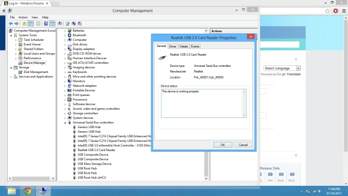

I've uploaded some images when the USB 3.0 is working as 2.0. And I've discovered that when USB 3.0 External HDD is connected before the boot of my OS, it opens as 3.0.

Saltgrass
Excellent Member
Microsoft Community Contributor
Oct 16, 2009
15,155
@Saltgrass , It's already enables in my bios.
In my system, EHCI Hand-off is Disabled in the Bios, you might try that.
Edit: I will go over your attachments and see if I notice anything. Is the Realtek USB 2.0 card reader built-in or have you added it?

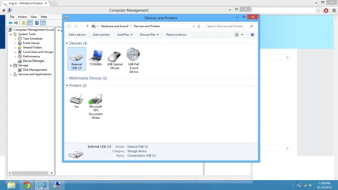

I added Realtek USB 2.0 Card Reader driver from Toshiba site. The images i uploaded before was when my PC detected 3.0 as 2.0. I've uploaded how it look like when the blue light appears. See the status of External USB 3.0 in Devices And Printers both in this post's picture and the picture from my last post.
