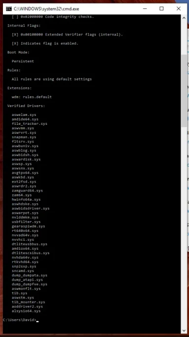

I haven't tried running verifier yet, because I didn't see that message until after I'd updated the drives and had had more updates, so was hoping that would have fixed the issue, but also because I hadn't rebooted since letting the drivers be updated and wasn't sure which version of the drivers that verifier would see and test, the old ones (if they were still in memory) or the new ones. I guess I'll do that test next.

A short while ago, I had just gone into edit on this message, I had attached a screengrab and was just starting to type in an addendum about it when the machine hung. No BZZZZT, it just simply hung. I didn't have anything system-stressing running, didn't have any youtube videos open either. Anyway, the attached screengrab is what I was attempting then to add, it is from me having turned on Verifier, and the screengrab is from me having invoked verifier /querysettings

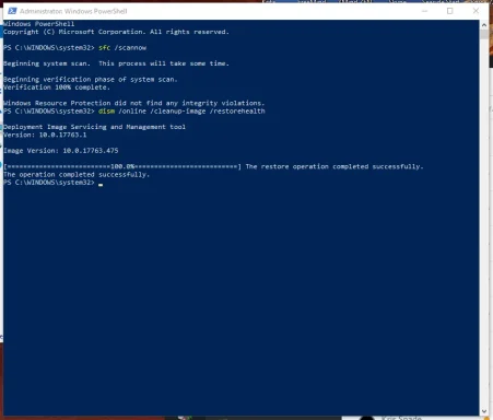

Okay, sfc /scannow yields "Windows Resource Protection did not find any integrity violations."
I am initiating the second action now.
And DISM? Did you run this scan or not?

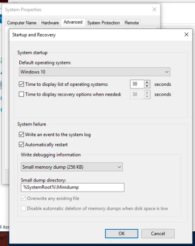

If there doesn't appear to be any dump files then you'll need to change your settings so that they're created when the machine bsods.
Open the run application.
Type sysdm.cpl in the run box and click ok.
Look across the top of the system properties box for 'Advanced' and click that.
Look for 'Startup and Recovery' near the bottom and click 'settings'.
Near the bottom you'll see a drop down menu under the heading 'write debugging information'.
In the drop down menu choose ' small memory dump (256KB)'
Under 'small dump directory' make sure it says %SystemRoot%\Minidump.
Click ok and your good to go.

Yeah, dism blahblah blahblah was what I initiated next, and was running when I sent that post, I just didn't want to type all that glop into the message. ;D
Event Viewer was something mentioned in message #12. Anyway, dism finished without finding any issues. As for the settings instructions you gave for me to set in system properties, it seems they were already set to that.
