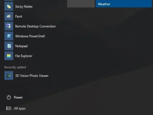

They have moved the power button and some folks don't like the new position just above the All Apps option. They may need to work on that and get it somewhere out of the way. I do like it better than the upper Right of the Start Screen, however.

OK, you can adjust the size of the Start Screen vertically but not horizontally, or so it seems.
You can see from the placement of the power button why some folks may feel it is too exposed.
