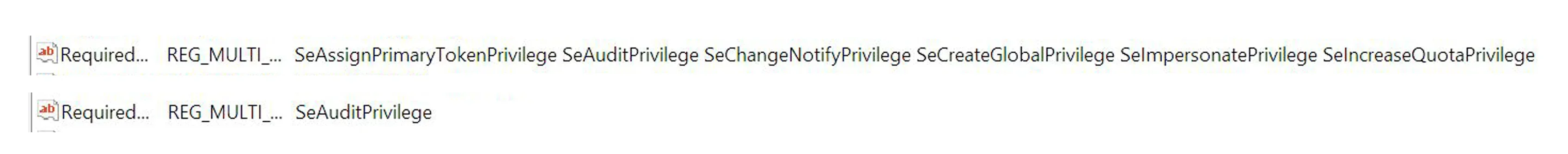

I superimposed the two images.
Other than the things that I would expect to be different, names etc this is the line that's not the same on the bfe and firewall entries.
Bfe on top...

Those two settings for those two keys look identical on my install. We'll wait for Saltgrass to check and confirm regarding his.

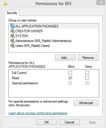

Link Removed
Link Removed
Full control wasn't set for anyone on the firewall service plus the first window has a category that says Everyone, the firewall window doesn't have an entry like that.
I changed the permissions to full for my user account and I'll reboot now.

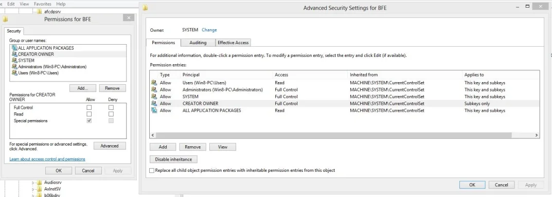

Mine looks about the same except BFE shows Base Filtering Engine for a Display name instead of the path, but probably doesn't matter.
Both BFE and MpsSvc show the attached permissions dialog. The Wfplwfs mentioned as being required for BFE is also a driver running and starting during boot. But since BFE is running, it is probably also.

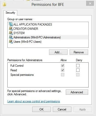

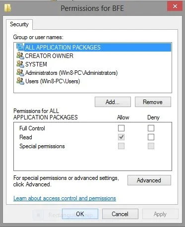

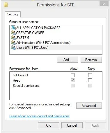

I took snips of my permissions setting on the BFE key and attached them FYI, in case you want to play somemore.
Both BFE and MpsSvc are set identically. The only thing I saw that was kinda unique was the settings for Creator Owner, which were set to "Special" "Full Control" "subkeys only". for what that's worth.

what i did was, to cut short... Hkey_local_machine\system\currentcontrolset\services\(bfe,mpssvc,sharedaccess), permission, add Everyone, then click full control. Thank you soooooo much bros
betong
New Member
Sep 16, 2013
6
what i did was, to cut short... Regedit, Hk
