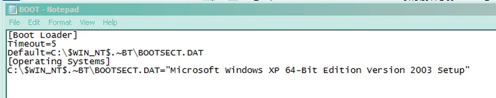

Can you open the files that have "Boot" in their names and see what's in them?
Use Note Pad.
If they have XP in the dialog they may be the culprit, I don't have any of these files on my C:\ drive.

Hi Mike , I will give a last try if the file doesn't come out encrypted.
Thanks again.
BINGO! that's it EUREKA!!!

#24
I will try to rename it xxBOT (?)
thanks a lot...God bless you and everybody that have spent their patience with me.

You are running on the XP MBR, not Windows 7. To rename the file could result in a failure to boot. I would suggest you have a live CD or the original Windows 7 DVD handy, just in case. But, as you have said you have Windows 7 showing in the dual boot, you may get lucky.

I don't really know why it is booting from the file other then the fact that it was interrupted during the install process.
I notice that the boot file you posted says "Setup" so I'm guessing this is a file created to continue the installation process.
I just don't know what will happen if you remove or rename it.
It may act like removing a XP install without removing it from the boot sequence as davehc says.
You should print out the following instructions on how to repair the boot manager in Windows 7 first to be on the safe side and have your disk handy as davehc says, if you decide to go ahead.
How to use the Bootrec.exe tool in the Windows Recovery Environment to troubleshoot and repair startup issues in Windows
My guess is that the only file you need to remove is the one you posted.
But this is an unusual situation, I have never seen a case where a computer running only Windows 7 booted from another boot manager and didn't show it in the BCD file.
So I guess it's up to you whether you want to have a go, or just live with it.

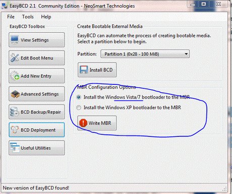

If you ever decide to go ahead, EasyBCD has an option, as Mike mentioned, to set your system to a Windows 7 boot (see attachment). There are other ways also. If you are already using the Windows 7 boot, it will not hurt, if you are using XP, it will set the system back to the Windows 7 boot.
My theory, and I think others may agree, is during your attempt to install XP, your system was set to look for an XP booting system. Possibly you used a third party boot manager to set it up... Since you only show one partition you could install XP to, you might have even tried to install XP over Windows 7. With some of the files I see in your attachments, you may even want to do a Repair Install of Windows 7. But only you know what really happened.
Exactly how it gets to Windows 7 is the mystery, unless it defaults since something in Boot.ini looks at the hidden files and sees a Windows 7 install. While you are hanging out, do you show a $Win_NT--- type file on your system. That may be the one pointing to the Windows 7 install.
Do you run Ad-Aware and have it set to run a bootcleaner during boot? This might also be effecting the boot (aaw7boot.txt)
You have a Windows.old.001 folder. Did you do an upgrade install of your current Windows 7 install over a previous OS?
Anyway, no response required and hopefully your system will run fine.

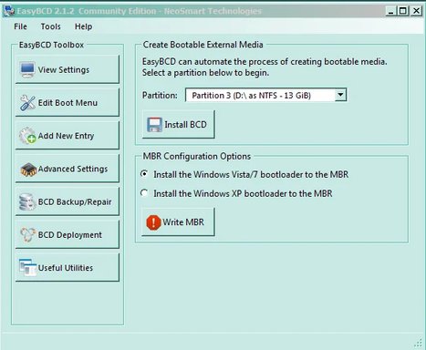

#30
Hi Saltgrass, I did like you said.
By the way,Looks like "EasyBCD" it is really a little jewel on managing the boot and checking that box I found something interesting to put another question.
I have a Recovery partition in D: (see attach.) Could I use the"Create Bootable External Media" to create a series of bootable Recovery DVDs? ...Thanks.
